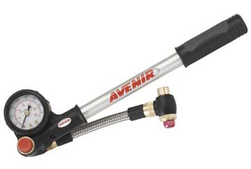

would a mini shock pump like the one below be good enough to pump up a 30cm chamber of 25mm pvc?
the reason i want to know is im looking for a small portable pump that i can use to pump my new gun on the move

I dont see why not, it just depends on how high the pump can go

Sure it will, looks like a good pump.
All you need is about an hour between shots...

wannabie: the pump goes up to 300 psi
Hotwired: lol
so it looks like it would be a sucky pump for the propose i want to use it for

How mobile do you want to be?
Track pumps are the best thing possible but they're about the same size as a small cannon too. A foot pump collapses to a fairly small size and pumps to decent pressures...

why not a track pump almost the same pressure but without the ages of refilling times!

iv got a track pump that i use to pump up my guns
but im looking for something really small that i can just shove in my bag and take with me

I have a shock pump like that, they are good pumps, they can pump to high pressures easily but I think you would soon get sick of pumping it.
I once connected one of these pumps directly to a gauge with about 10cm of pressure hose in between to test my gauge. Even with such a small volume of air it takes about 30 pumps to reach 250psi. I also tried pumping a used 9oz paintball tank with it, it takes over 150 pumps to get 100psi.
Although the pump in the picture looks a tad bigger than mine.
