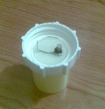

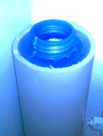

Anyways, combustions, yes... Well, version 1.1 is currently curing. What I did was hack a 35 litre drum apart in order to have a screw-on endcap. Granted, these things aren't pressure rated, but it originally contained 98% sulphuric acid so it's pretty tough stuff (quite a chore to hack up anyway) and besides, most of the surface is reinforced with epoxy.
I got my hands on a new ignitor that's now cast into the cap, ladies and gentlement, I give you ADJUSTABILITY<SUP>TM</SUP> :D

The yellow part is just there as a &amp;quot;stand&amp;quot;
The yellow part is just there as a &quot;stand&quot;
Hey that's pretty cool there Jack.
