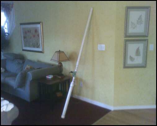

one of my engineering projects this year requires me to launch an egg approx. 50 yards, so i decided to make a compressed air canon. doing some research i stumbled across this forum. i made the canon and man is it cool. the only pic i have now is from my cell phone and is not a close up.
the canon worked great for testing. i was shooting approx. 20 ounces of water at 60-80 psi and it was traveling maybe 20-30 feet.
my setup:
2" by 2' pvc for the chamber
leads down to a 3/4" sprinkler valve
leads up to a 1.5" 4' long barrel (had to keep the barrel 4' long [it was the only required thing for the project])
the thing is that i wired up a toggle switch for the valve, but the switch did not work and i had to use the little manual lever on the valve.
the major problem however is that the sprinkler valve does not hold air anymore. i think i might have exceeded the max. psi it can handle.
if anyone knows what could be the problem i would appreciate any help or ideas of other valves.
and sorry for the long write up.

The valves can hold around 125 psi, so I doubt you exeeded its max pressure. Try taking the valve apart and putting vaseline on the rubber diaphram.

Vaseline is the last thing you want to use to grease the diaphragm. It slowly eats at rubber. Try silicon grease (more expensive, but much better).

nothing should come out except the diaphragm, and thats supposed to be removable. if something else comes out, that's why it isnt working, lol. just make sure that when you put it back together, you tighten the screws down, ALOT as these are what is making it airtight.
