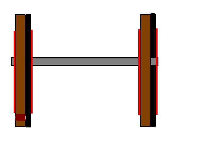

[quote="Gippeto"]
Assemble in this order (front to back);
Nut, washer, rubber sealing face, wood disk, washer, nut, (length of rod), nut, washer, rubber disk, wood disk, washer, nut.
quote]
The front is the sealing or barrel side. The washer should fit inside your barrel.
I'll leave off the nuts. The washers are in red.

Thank you.

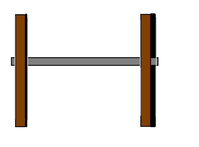

- piston.JPG (13.51 KiB) Viewed 1258 times

*cough* mass *cough* heavy chgrmm*psycix wrote:but I made a new one out of a solid wood so I could add an o-ring.
[/quote
I think it was clide who said that unless your piston is really heavy, weight doesn't effect opening time too much.
I've said that a few times as well.MrCrowley wrote:I think it was clide who said that unless your piston is really heavy, weight doesn't effect opening time too much.
I could effectively halve the mass of the pistons I currently use and see no discernible performance improvement. I'd struggle to spot the difference if I had a chrony to be frank. However my pistons aren't exactly hugely heavy in the first place.
Doesn't mean that heavy pistons should be ignored though. It's still a good idea to keep the weight down as much as possible.

Piston weight may not affect opening time... but a heavier piston has more momentum... so keeping weight to a minimum is generally a good idea to reduce the chance of damage to a cannon, especially PVC ones.
