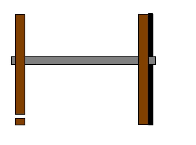

I will upload a beter illistration of what I will probably do.
BTW this is not proportional, or centered. Just a quick 5 min MS paint sketch
Thanks Gippeto
The hole is going to be 1/4 in so the 3" by 2' plus a little 1.5" tube chamber dose not take a week to fill

That's the idea. :)
But leave the equalization hole out. You won't need it.
Trust me. :)
Also, consider using a second rubber disk to act as a check valve on the rear disk.
Assemble in this order (front to back);
Nut, washer, rubber sealing face, wood disk, washer, nut, (length of rod), nut, washer, rubber disk, wood disk, washer, nut.
When filling, the air will push past the rubber disks (IF you fill from the pilot like most everyone does.), when piloting, the rubber disks will be pushed against the wood disks and the valve housing walls, helping to reduce total piloted volume. :)
What are you planning as a bumper?

To late to cast. I bought all the stuff to day to make the one above.
Iwill put a piece of rubber on the back but Gippeto, shouldn't I put the rubber closest to the barrel on the outside of the wood to act as a sealing face?
as for the bumper I will use rubber tube I have, from a talk box for guitar that I made. The thing blew up and I do not plan on remaking it. It is 1 inch house, the clear stuff.
