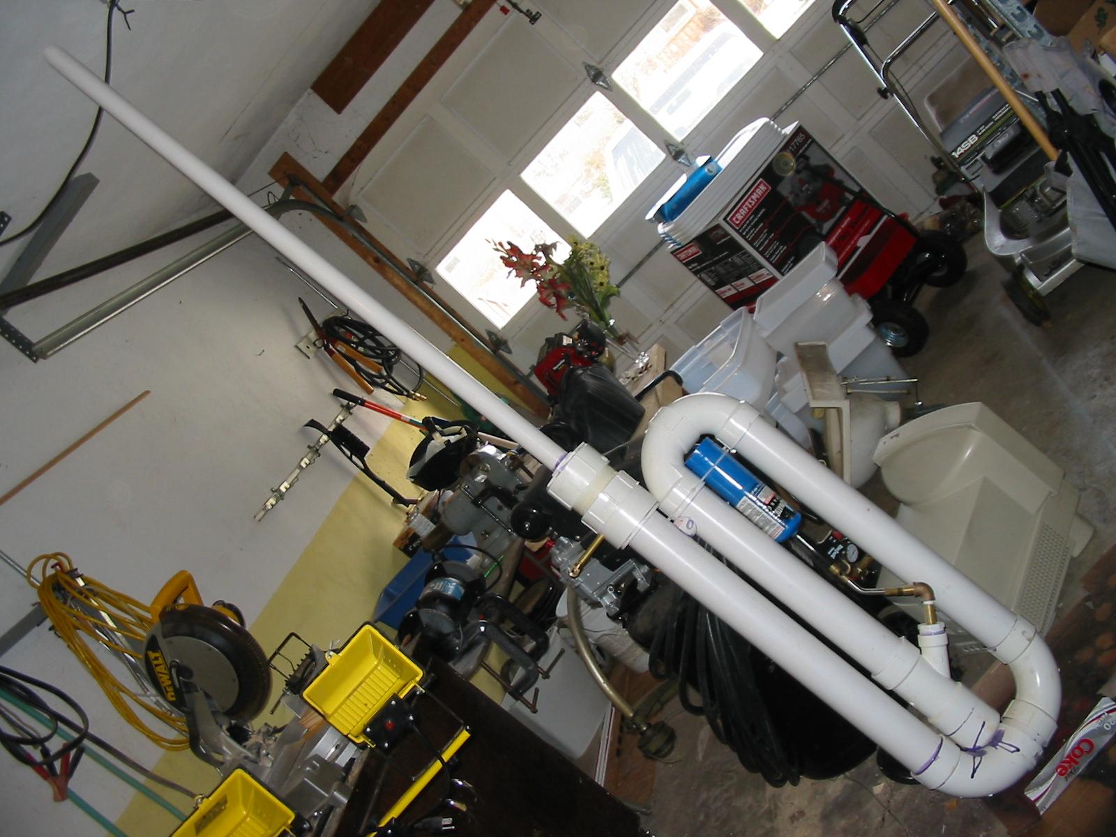

[quote="Xxplosive42o"]His cannon has a release valve that operates the same as yours and is pictured below. The picture that shows it was apparently removed but I dug it back up. The blowtorch piece you’re using pre-mixes air exactly like his; except yours is more advanced. The only thing his setup has that yours does not is the open/close valve. It really serves no purpose because he is not using a metering system. Besides that your cannons work identically. Oh wait, yours has it's ignition built into the starter.
Cheers!
his design also uses the torch for ignition tho klugeboy's design has separate ignition
