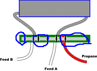

jackssmirkingrevenge wrote:Why not have just one feed from a premixed reservoir?
Safety reasons.
Three simple rules I recall D_Hall reciting at one point:
- Don't have it around before you need it.
- Don't have more of it than you need at any one time
- Don't have workers around that don't need to be.
The last of the three doesn't really apply here, but that's the simple fact of the matter. It might not be dangerous having it, but I'm diligent about safety, and having a pre-mixed tank would break the first two rules.
Also, a premixed reservoir would require a lot of space. In theory, this design just needs the propane tank and an air flow - which could be some kind of fan which doesn't take much space.

EDIT: No, those bits don't have to be turned down. You could do it for weight reasons if you wanted.
But it's like that in the animation because I couldn't be arsed to make it that way. The valve was just done with a grey rectangle to which I attached identical O-ring shape bits to save time and effort when I had to adjust things around to get it all working right.
