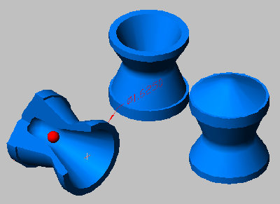

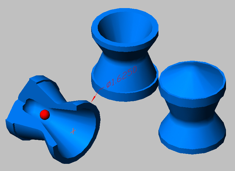

JSR, How would this design work? This for rifled 1.5 inch sched 40 barrels. Volume is 1.89 cu inch. It would weigh about 3/4 lb in lead. The red dot is center of gravity. The nose could be made sharper, this would move CG forward. Could be scaled up or down.
Large Pellet
Large Pellet
Nice rendering :)
That should work well even without a rifled barrel, and a sharper nose would both add stability and increase aerodynamic efficiency and penetration. What's the material and construction technique you had in mind?

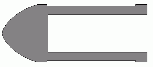

Also, would it not be simpler to have the projectile made foster-style as a straight walled cylinder? Perhaps with the body slightly turned down to reduce barrel friction, something like this:
