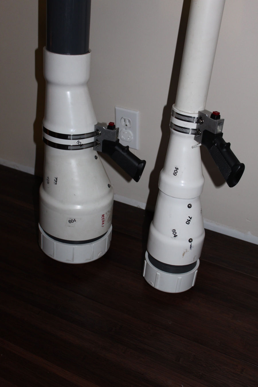

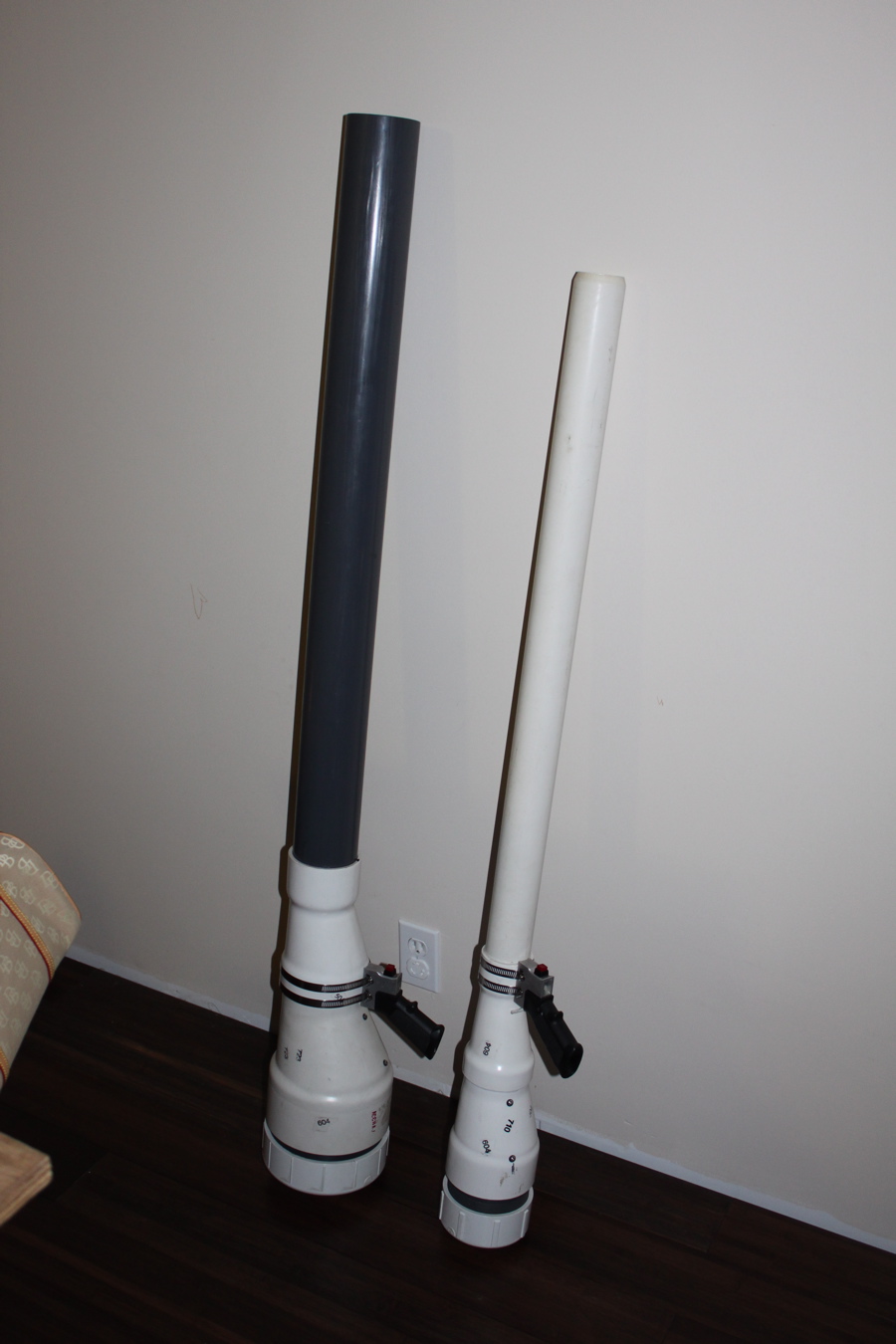

Baseball shooter for customer...
AR-15 pistol grip
Sureshot aluminum switch/handle assembly (<a href="http://ultimatespudgun.com/pistol-grip- ... ARI-101</a>)
30KV ignition module
3" schedule 80 barrel diameter
6" threaded cap
1 : 1 CB ratio
40" barrel
The special coupling is pressure rated (130PSI continuous)
Retail on web site $130
Chrony showed top speed of 324fps (220mph) and 715ft/lbs energy! HGDT predicted 158fps, we were surprised. Schedule 80 3" is really as good a fit as anyone could ask for baseball. Ball fits just snug enough to hold position in barrel. Customer threatens to have us build BL-630.
This could easily support schedule 40 2.5" for tennis balls
Videos to come
AR-15 pistol grip, Handle assembly, switch and igniter only $50 (<a href="http://ultimatespudgun.com/pistol-grip- ... ARI-101</a>)
You supply the hose clamps to attach to virtually any rig.
Sureshot ML-630e

definitely it's much more affordable while it still has some nice features... spudguns for the masses - that seems like a good idea
Neat coupling. I'm sure it helps to "go with the flow" through the barrel porting.
I hope this isn't meant as a training deviceChrony showed top speed of 324fps (220mph) and 715ft/lbs energy! HGDT predicted 158fps, we were surprised.
I'm thinking add metering + fan and interchangeable barrel system to accommodate a wide range of pitches.
nah, but this customer has an interesting use... warding off aliens.

Thank you... They are made by Spears fabrication team. Feel free to PM me if your interested in one.Chernobyl wrote:Are those ECCENTRIC PVC REDUCERS?! where did you find them? oh, NICE SLEEK cannons too!
That might be the outward impression but I think you'll find they're fairly reasonable if you take the time to get to know them properlyChernobyl wrote:Are those ECCENTRIC PVC REDUCERS?
