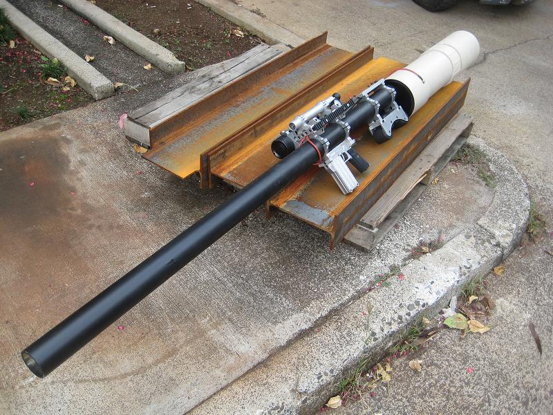

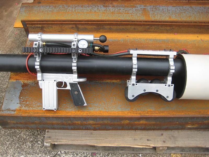

Just completed and test fired. Still awaiting Chrony results but thought to share the initial prototype photos. Performance info /damage video to come shortly.
Sureshot components
Ignition - PGI-101
Metering - FMD-101
Clamps - PM-101 & MRS-251 (available soon)
Offset parts - OCK-625 (available soon)
625 shoulder pad/Conduit package (available soon)
Specs:

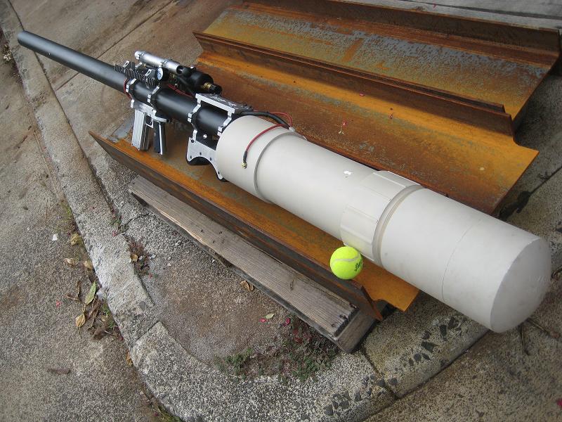

1.25 chamber to barrel ratio
575 cubic inch chamber (6" diameter)
8' barrel (2.5" diameter)
MAPP gas
Costco potatoes (1 pounders!) and tennis balls woohoo very few are reuasable they are splitting on impact.
Riot to shoot, definately way more fun crew serve.

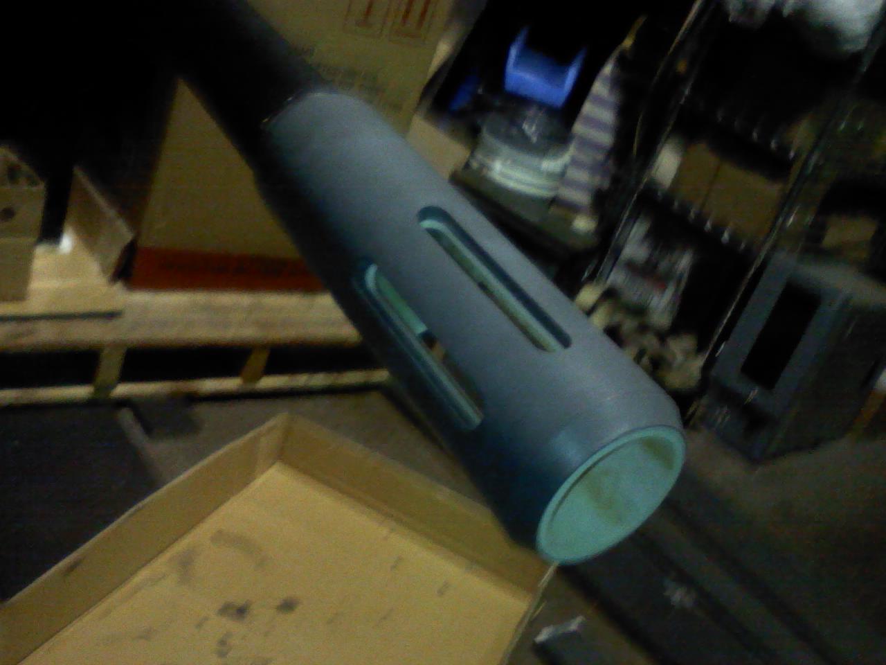

EDIT: muzzle brake prototype. Sched 40 2.5" sleeved Schedule 80 3" glued turned and slotted...

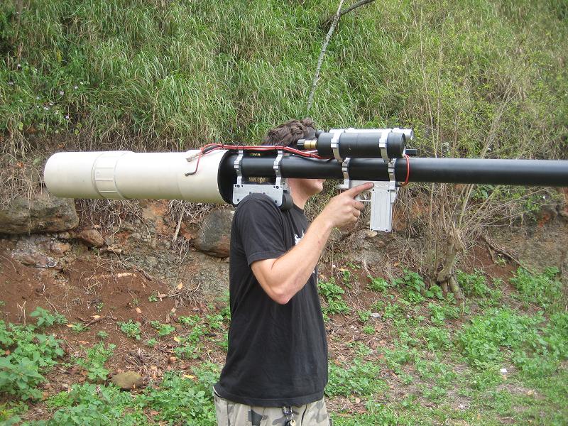

shoulder mount
shoulder mount

Muzzle brake prototype photo

That is a sexy gun, and yes, I do say that to just about every single one I comment on, but this one deserves it especially. Very good call on the shoulder mount, the last one did look a little unfitted to any form of hold.

*1.25 chamber to barrel Ratio
2.5" Diameter Barrel
6" Diameter Chamber
Offset to run vent tube and fan

Jagerbond, this thing is just about at the limit of practicality for human hand holding. Still, it's a really nice setup with the shoulder mount.

I agree, it weighs about 45lbs. and could use a tad more weight on the front for a perfect balance. The rear cap and female adapter accounts for 7lbs! I guess its necessary, the math says with a peak of 60psi that the cap is seeing nearly 1700lbs force pushing on it.
With that said, I don't seem to notice any weight while bearing down on the target ready to pull the trigger.
Mike

For me, the real advantage is the giant Costco potatoes. They are $12 for 20lbs (about 25 spuds) and they are so big that the 520 was trimming a lot off. This 625 wastes very little when loading and still maintains a good seal. With the 1 pounders I found myself nearly sitting down on the first shot.
Tennis balls can be reusable depending on what it hits. Today we we're punching holes through 1/2 ply at 15 yards with them, and exit damage was impressive. Hitting hard stuff left yellow circles and we could only re-use the balls that didn't break only a few times before failing. Straight up shots felt like eternity before returning to earth, we'll time some tomorrow. We quickly put together a syringe set-up for the garden hose -- filled the tennis balls with water and found performance was pretty awesome. For this gun water filled tennis balls is a nice blend of speed and energy.
