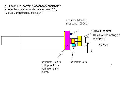

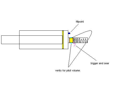

I just posted a ROUGH drawing of a sear released valve the other day... Here it is again... It's actually a sear released pilot, that uses a dump valve similar to tech's, for an extremely large pilot vent(relative to pilot volume)... but also allows for light trigger pull even with HIGH chamber pressures...

And here is a method of using a stepdown for a 1500+psi chamber volume and a 500psi< pilot volume, so that you could build a LARGE, VERY HIGH PRESSURE, cannon that could still be piloted by a $12 qev...
The descriptions in the picture is for a large copper cannon, but the principles would still apply for a large bore steel cannon...

jeepkahn wrote:I just posted a ROUGH drawing of a sear released valve the other day... Here it is again... It's actually a sear released pilot, that uses a dump valve similar to tech's, for an extremely large pilot vent(relative to pilot volume)... but also allows for light trigger pull even with HIGH chamber pressures...
Now I understand. The pilot is the only part you are talking about. The main cannon valve is still a traditional barrel sealer piston valve. I was trying to see how you would trigger the main valve that way.
Egg-Zactly.... the performance is going to come from the large ventability relative to pilot volume...I'm not sure the efficiency rating of the QDV but, I do know that a QEV is only about 40-45% ....
And I just did the math, on a 2"barrel/4"chamber filled to 1500psi, using a 1" pilot connector and a 4" pilot disc, you would only need 100psi in the pilot chamber to hold the valve closed if using the stepped pilot....
Either way, this would definitely be the trick for piloting high pressure guns without worry of qev failure, or having to use a ballvalve to fire...

All this time I thought you were trying to use it for the main valve. :(
:D Great job on the math. The piloting of the high pressure valve looks like a workable solution. I like it. :D

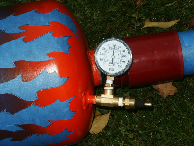

Thanks. I'm using about and 8 inch diameter chamber and feeding into a 2 inch coaxial valve. That must help.
In regards to the "Optimum" opening distance, I never liked the math of matching the opening to the barrel area. It seemed to me like stacking 2 stop signs on a road near each other. Removing one restriction to flow and letting the other provide the only major choke point to flow seemed like a good idea. For this reason I ported my 2 inch valve with 1 inch tall ports so the total port area is considerably larger than the valve seat area instead of equal to it.
Chamber diameter to Valve outlet diameter of the 2 inch QDV cannon.  The valve is inside the chamber.

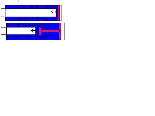

One of the reasons that practice overrides theory is because you've got to look at all aspects of layout/design/interaction... You have to not only look at the valve, but also how much proximal volume is available to the valve/barrel.. theoretically your gun would actually benefit from the chamber to barrel ports being centered(frt to rear) in your chamber, as opposed to being rearward or forward... a coax with a closer ratio of chamber to barrel diameter than your setup would be limited because of the inability to maintain pressure at the breech due to the frictional losses of pressure in a smaller chamber as the air flows out the barrel, so you see less effective pressure applied to the projectile due to inability of the air(even under pressure) to keep up...
these crappy drawings help illustrate... the coax on top has limits due to frictional losses as the pressure exits the barrel and the air further up the chamber has to overcome those frictional losses tokeep the breech area pressure up, the coax on the bottom has more proximal volume available before it has to rely on the breech area to be "refilled"...
