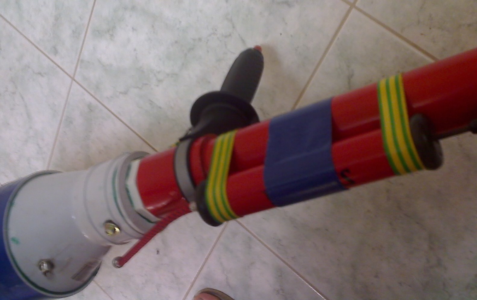

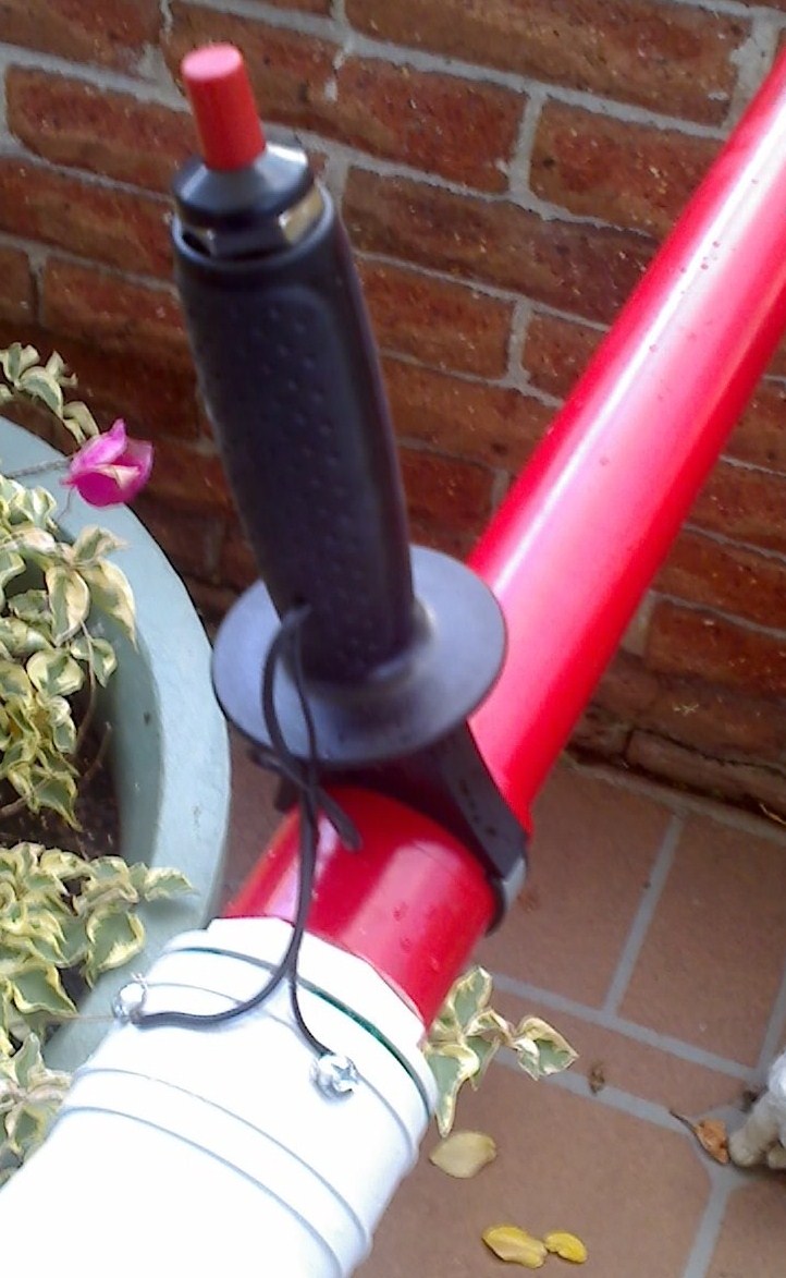

after having a think about it and using spudtyrant's diagram,ive now rigged the piezzo into the drill handle,it works a treat now and is a lot safer,,
and about the port/vavle did u think it was a pnumatic cannon????,,putting the ignitor in the cap was scary,but pressuring dwv is fucking phsyco.....
ive attached some more pics of the new ignition...

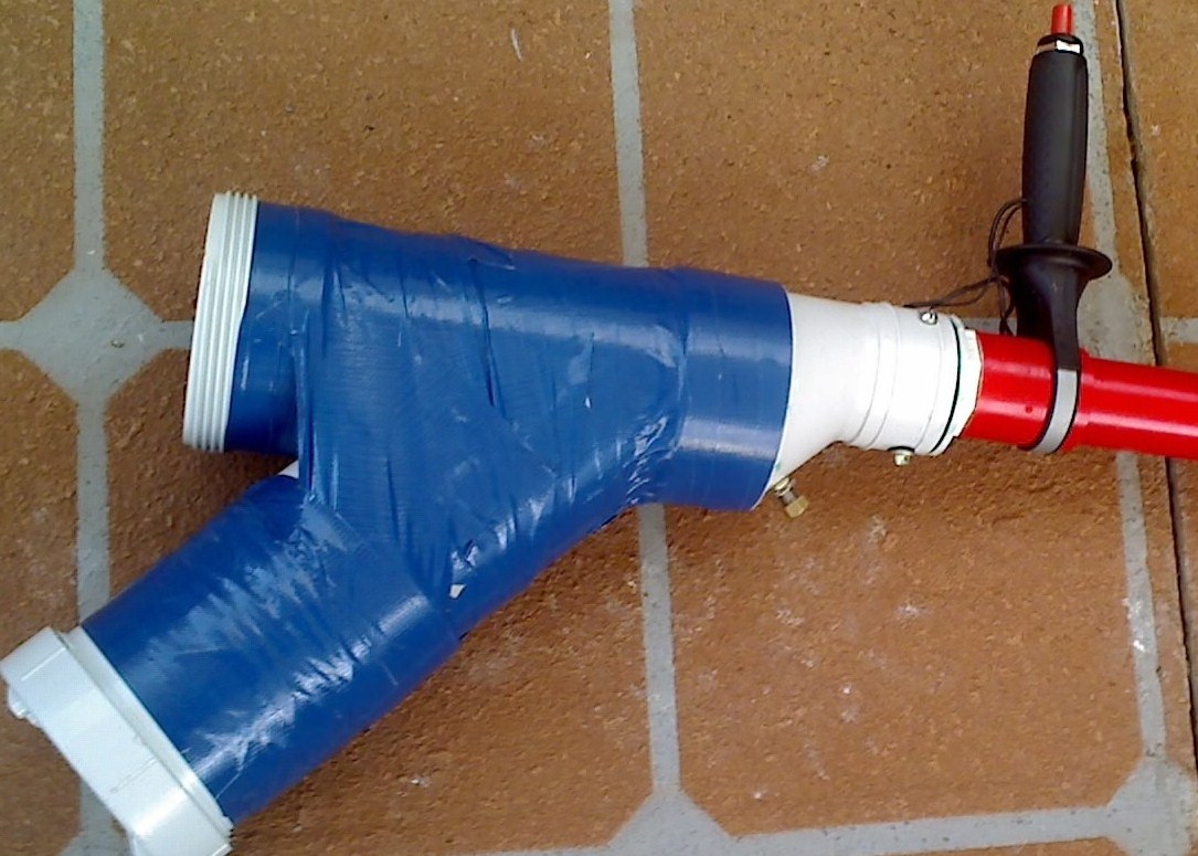

hey Gaderelguitarist ive used ur idea of a sharder vavlve to refuel ,with hair sparay ,i pulled the centerpin/vavlve inards out so it can be refueled via the sharder valve,as u would with quick connect air fittings
works a treat :P :wink:

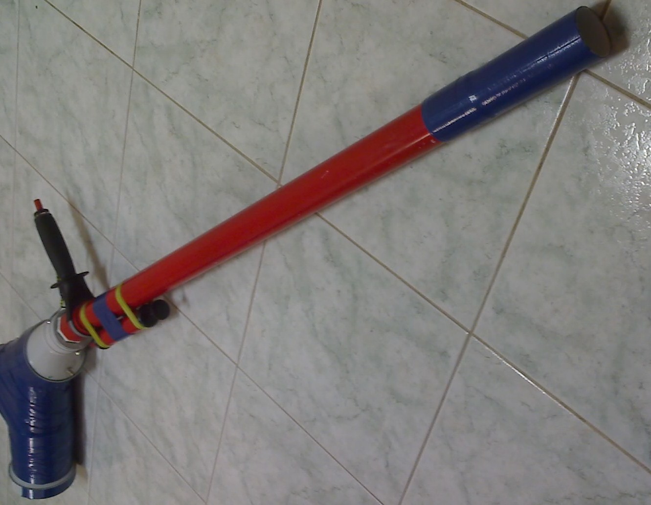

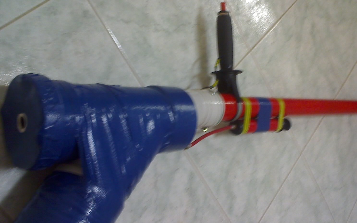

and the final product( i think)!!!! i added a bike pump to clear the chamber
of dodgy gases
bike pump attachment
booyaa
booyaa
rear view ,im yet to replace the end cap..

Nice job the only thing i would have done was put the screws further back in the chamber.
You can just leave the current screws in and splice some wire and put new ones where you want them.
you want your screws at the screw cap fitting here http://img158.imageshack.us/img158/3077/newscrew.jpg
on your chamber for the best ignition.
You will get dodgy ignition with you current placement, gasses are heavier than air so if you firing up or at any kind of an angle most of them will drop to the bottom of the chamber and will have trouble igniting
I would say scrap the bike pump because it doesn't do to much to ven,t but it looks so cool lol

damm i nearly got it right lol, yeah i was looking for the thickest part to put the screws in ,and where i choose was three layers thick of plastic
ive dry fired the thing about 15 times and now i can realy appriciate y there called spray and prays
if u consider how i fire it (with the junction arm facing down)would it be more viable to put the screws in the lower arm????
im refuling with everything upright (the hairspray and the cannon)
via the shrder valve
spudtyrrant
Posts: 550
the junction arm should work even better i would mount it on top of the top of the wye fitting going out to the juction arm where it is double layered.
as far as fueling goes i would just cover or plug the schrader and open the screw cap to fuel that has always worked best for me because the aerosol goes into the whole chamber and is not just shot to one wall.
