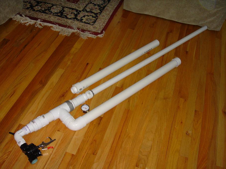

This is my first working piston cannon and my first post on spudfiles. :D
I usually only pump this up to around 90 - 100psi and i made two barrels.
- 1 1/4" potato barrel - 2" sleeved into 2"PVC (golfball barrel)
Specs:
- 2" chamber
- modded sprinkler valve (pilot valve)
- plywood piston (i got the idea from MrCrowly)
shot a golf ball 350+ yards

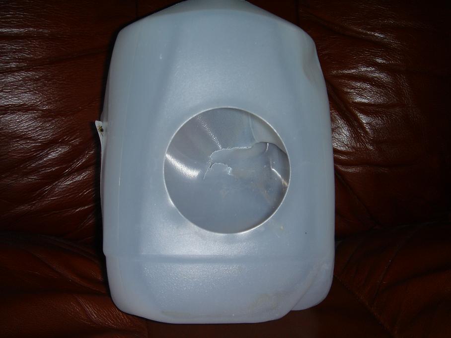

damage from a 1 1/4" potato slug

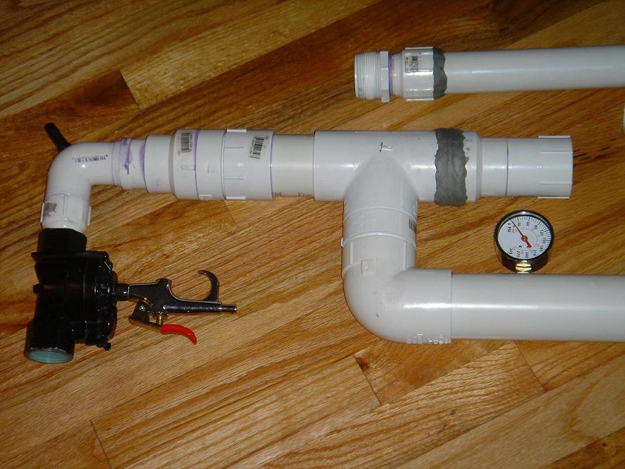

pilot valve and piston housing

blind909
Posts: 828
Location: Las Vegas, NV
Nice cannon! And welcome to spudfiles. It looks a little akward to hold though.

Cool cannon, is that gray stuff leak sealant?

umm no. it epoxy putty. after i finished it there was a small leak there but now its fine.

i like the cannon but i see some DWV --- i one on the pilot is a easy fix but the one on the front is going to be a hard fix and maybe a cannon ender
p.s. you should drill and tap your psi gauge on a fitting so you more then just one layer of pvc

:shock: oh no. i think i might just leave it because i never take it over 100psi and its hasnt broken yet. you're right though, i really should fix it.

100 PSI is still a hell of alot of pressure on non-pressure rated fittings, I would say around 60-80 psi, just to be safe, because we all know how catastrophic it is when PVC ruptures. :shock:

nice cannon, and i have a input on the DWV, you have it on the worst possible places since those fittings take the smack of the piston

you're right. i think i might actually fix it now cuz i dont want to die next time i shoot this thing.
