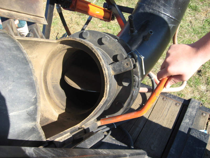

It's nice when you can be this close to a pumpkin cannon.<br /><br />Photo credit.. Photo from Roberts High School.

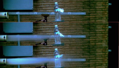

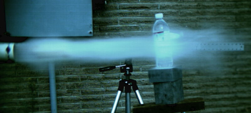

Mist from failing apple exits first.
3 frames.jpg (24.04 KiB) Viewed 3684 times
The bulk of the apple exits later.  Many of the smaller pieces are way ahead of the bulk of the apple.

My ASME team might consider registering as a side project. It seems the contest is essentially longest barrel and highest pressure (to an extent) wins. It's all an issue of money, time, and space to build. Is there any evidence of a pumpkin gun using anything else than a butterfly/ball valve? It would seem like it would have the leading edge to victory.

Butterfly and ball valves are acceptable in punkin chunkin due to the massive barrel. The huge flow you get, along with them being easy to get (and rated) makes them ideal, especially when actuated by a ram or similar.
