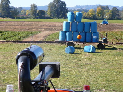

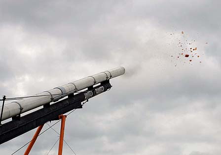

Edit.. looked up pressure for pie in the sky.. Better results.. People hide what works but often tell what fails..Chunkin Up was fabricated circa 1997 and has gone through many modifications since then. The exact specifications are top secret.
Open a valve. Watch the pumpkin soar.
At 140 psi, Nietubicz' pumpkin bursts inside the tube, emerging from the 65-foot barrel of his air cannon looking like the old Atari game "Asteroids."
- Pie in the sky.
