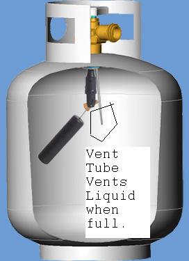

It is much easier to fill by vent tube. Fill until the vent starts to pick up liquid and shut off the fill and then the vent. Done. Tank can be part of the launcher.ramses wrote:well if you make the new tank out of steel pipe fittings, there would be no need for a safety valve since they have been tested to 11x. (max peak ~1100psi). but still only fill to around 80%. Fill the tank by weight(use a scale) like they do with CO2 tank. the density of liquid propane is approximately 0.5077 g/cm.
- Vent tube picks up liquid whent the level reaches the end of the tube.
- lp_opd1.JPG (14.5 KiB) Viewed 2111 times

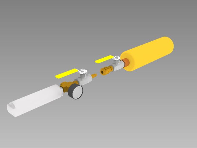

Cludged this together. The 1/4 npt cross, gauge, and nipple are nearly as big as the 8 cubic inch tank. I didn't model it in, but the open port on the cross is for a safety relief valve.
- Concept of a reduced size refillable LPG tank.
- fuel concept 1.jpg (13.46 KiB) Viewed 2069 times
