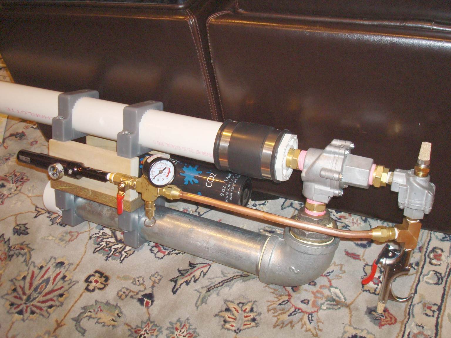

Found this (not my pic stolen from internet) Is this kind of what I need to do? With solenoid valve in place of blow gun assmebly.
QEV piloted by smaller QEV

Not sure if get what you mean but yes you can use two qevs like in the picture and fill/pilot using a 3/2 valve.
What size is your 3/2 solenoid valve ? If you keep the pilot volume low I think you can pilot the 3/4 qev directly with the solenoid valve.

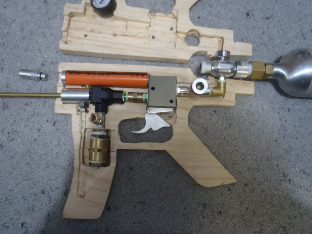

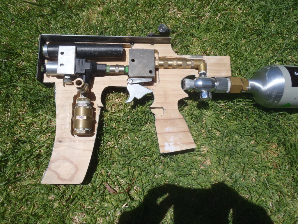

Slightly off topic think I have started enough threads! these too pictures came from google think its same gun just different stages but after black qev what have the done? What is the reddish part in first pic and the back/silver in second photo? Almost looks like some sort of ammo feeding system?
Thanks..
