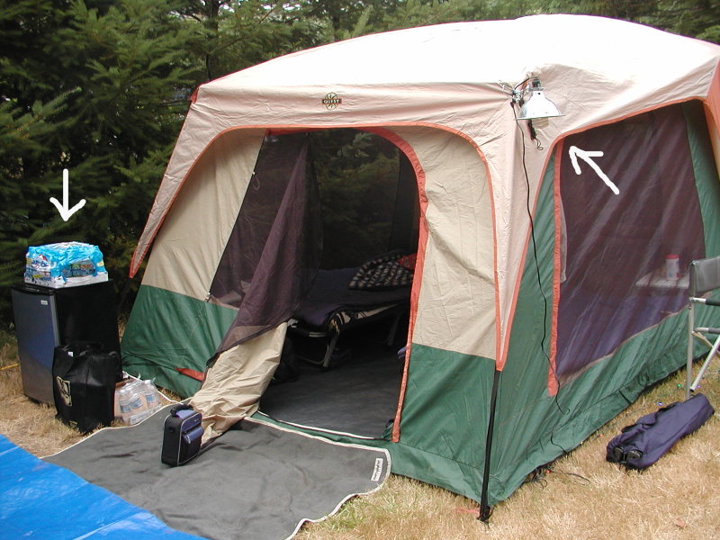

It does run a small refrigerator just fine as long as it is one that doesn't have a heater to auto defrost.POLAND_SPUD wrote:
well if you are looking for a portable compressor you might be better off with what tech uses...
he bought an inverter and a small air compressor (you'll have to pm him or find the thread where he mentions it)
Link...
http://www.spudfiles.com/forums/how-to- ... art,30.html
I use it camping with a fridge instead of an ice chest.
