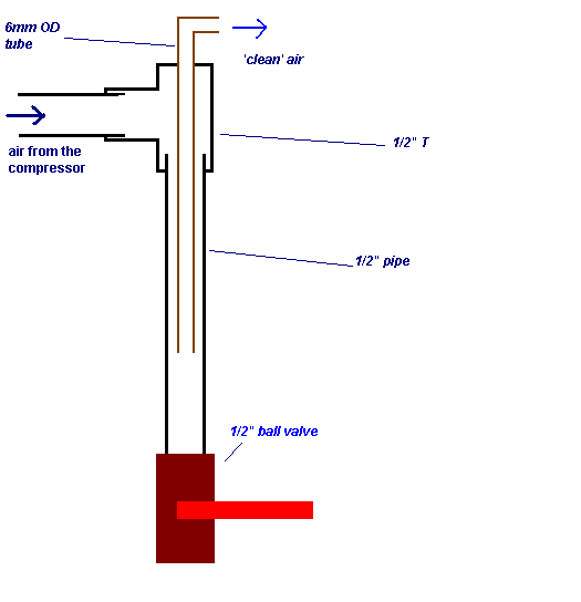

so you are saying that even something as simple as what you can see in my drawing will work ??
if I understand you correctly there are two possibilities here (well.. actually 3 ):
-add some sort of helix to force air to rotate around the smaller tube, which will centrifugally separate oil
-add some sort of screening material, like wire mesh or stuff used in air intake filters for cars
- mix the two ideas
the biggest advantage of centrifugal oil seperator is higher flow, right ? would I really need it on a fridge compressor ?
harbor freight is not an option for me... shipping would cost too much
- mix the two ideas

I think that would work except make it a 3 stage filtering process. by having two filters instead of one you can be sure that at least 80% of the oil has been filtered out of the air.

that should work fine poland.
good idea with the ball valve i would empty it after every fill tho just to make sure you don't get any oil in your cannon or airgungun.

You can just bubble the air through water. S in your drawing, the clean air out would be input, the bottom red part replaced with a end cap, and filled with water to the .5" tee.

It really depends on just how much $$$, just how well you need it to work and just how much oil is actually in the air stream.
If you just want most of the oil out of the air stream, and there isn't all that much to begin with, then you can just blow it through wire mesh. Occasionally you remove the mesh and clean r repalce it. Something like coarse steel wool would work well for the mesh. Just lightly pack the mesh inside of a tube. I've also seen several layers of say 1/16" grid hardware cloth used as an oil trap.
Bubling through water isn't going to work well at high flow rates, you won't catch much oil and you'll saturate the air with water, heck you'll get greater than 100% water saturation in the air stream because of fine droplets that form as the air exits the water.
