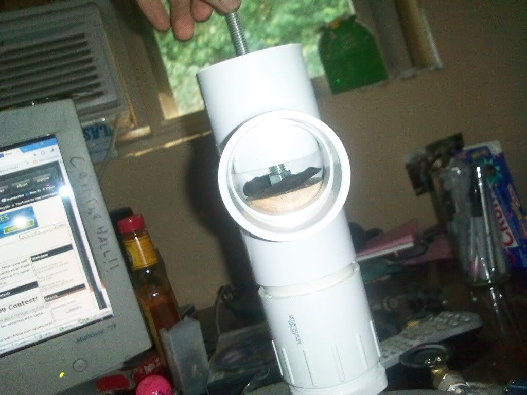

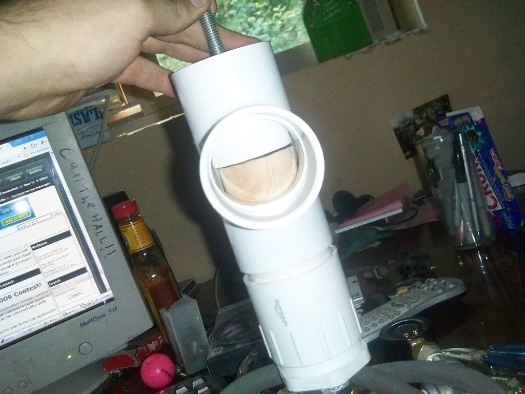

yea i think ive got things figured, my piston chamber is the T so my piston needs to be the width of it, working on boring out my 2" T not going so well, i have to do it by hand, no press, i tried on a scrap T and i ended up chewing in to the side wall of the T
EDIT: i think my hole saw is to harsh for my piston, i kinda wish i had one i could take apart and look at then im sure id under stand how to build this stupid thing
EDIT: So im an idiot. . . and sorry for my lack of understanding, but i believe im starting to under stand, i dont cut out the lip of my piston T unless its in the way of my piston, ill get a picture of what i think i should be doing
@tech i under stand how it works just not how to build the stupid thing

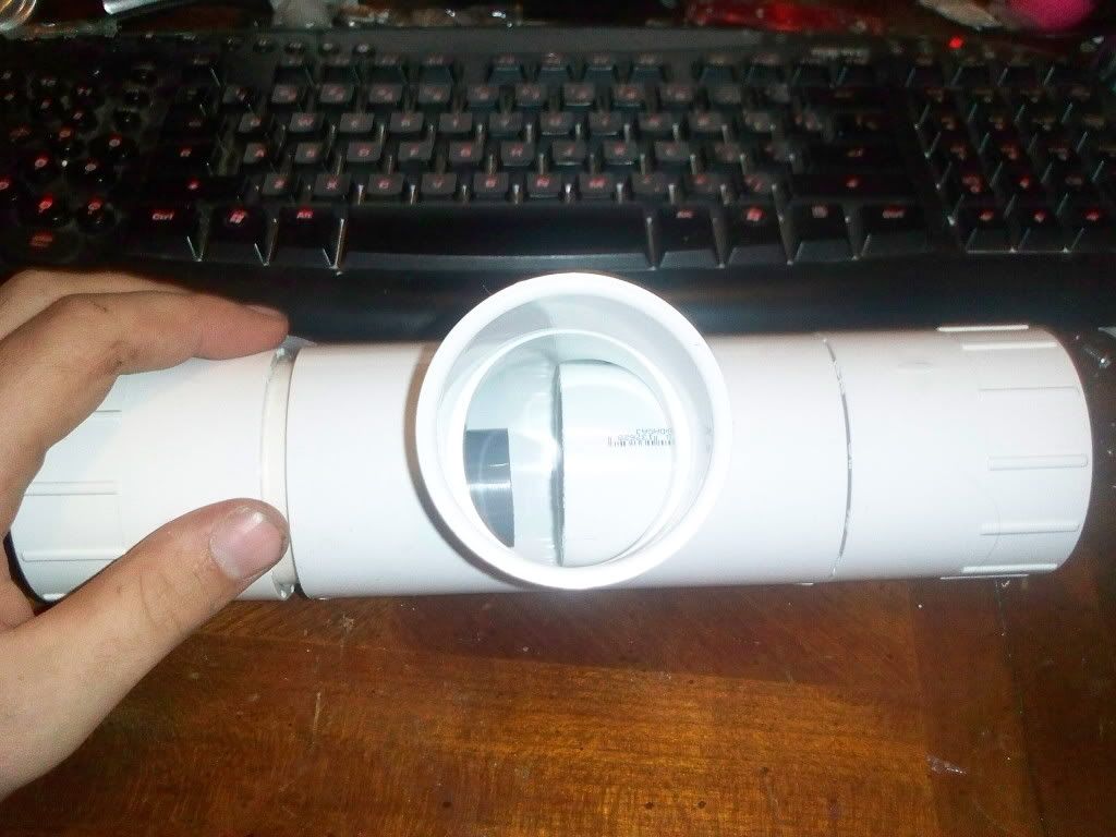

if that grey piece of PVC was my piston the same size as the ID of my 2" PVC and the white piece of PVC was a peice of golf ball barrel id be on the right track?
SO i cut a bunch of wood @ 60mm caus thats the closest think i have and glue them together sand/grind them till they just barely fit in my 2" PVC and thats my piston then i have my barrel seat half way into my T that gives me the face for my piston to seal against . . . piston is 2" and barrel is 1.7 inch inside so my piston is smaller than my barrel
