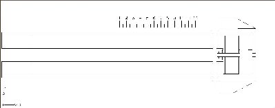

Ok well here's a new update. I've been getting feedback from members on chat and have nearly finalized the gun. I redid the model in AutoCAD and it's starting to look good.
What isn't shown: A 3/4NPT QEV will port the back and that will be ported by a blowgun. The input will be the Kobalt CO2 regulator set at 100 psi.
EDIT: does anyone recommend a spring behind the piston?

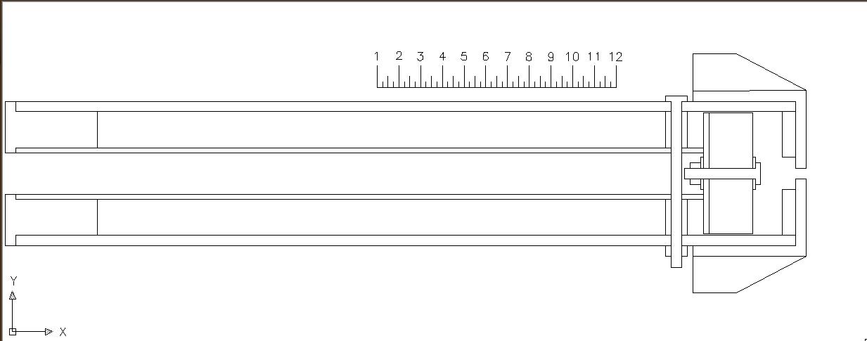

Sealing a bolt through the chamber and barrel will be extremely difficult.
If the pin is to prevent the shirt from impacting the valve, drilling the end of the barrel and inserting a headless bolt that does not extend the length outside the barrel and then sealing it with a coupler on the outside of the barrel work well. Then a barrel support away from the breech of the barrel will remove the support structure away from the high velocity area. The support can be entirely internal so it doesn't compromise the pressure chamber integrity.
That will take a lot of wasted air to operate. Model it in GGDT. At 100 PSI, the volume of air will expand upon release about 5X. Having a chamber several times the volume of the chamber is a waste of energy. Consider enlarging the barrel to reduce the volume of the chamber. A chamber with as little as 1/3 to 1/2 the volume of the barrel works very well.
Back to the original question, the cannon if filled from the pilot will not need a spring if the EQ between the piston and chamber is not too large.

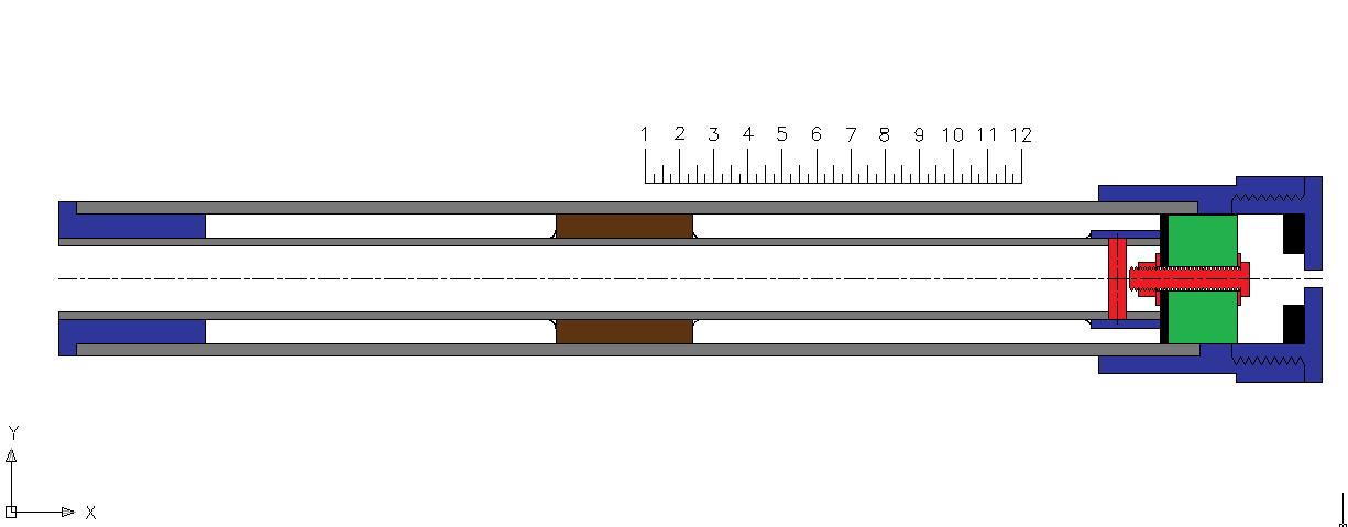

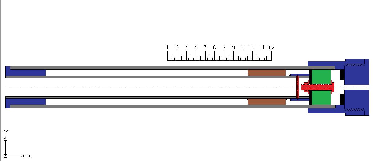

New design update:
Fixed the diameter of the chamber.
Removed the centering bolt
Put in centering blocks
Put in piston block pin
Added threads
Made the end a threaded plug/cleanout cap
Added color
Like always, feedback is appreciated

- The Updated Design
- Untitled.jpg (39.51 KiB) Viewed 2103 times

Much better. The shirt stop doesn't have to be huge. Big reduces flow. Anything you can't bend with airflow or pressure stuffing in a shirt is fine. A 16p nail is cheap.
The centering blocks can be moved rearward. A location about 6 inches from the breech provides excellent rigidity for postion.
The close ratio piston (OD is closer to the valve seat diameter) will improve the opening speed. I think you will like that.
Now check the parts store. It is unlikely you will find a plug the piston will slide into as shown. Most will have an ID smaller than the ID of the pipe.

Better?Technician1002 wrote:Much better. The shirt stop doesn't have to be huge. Big reduces flow. Anything you can't bend with airflow or pressure stuffing in a shirt is fine. A 16p nail is cheap.

Alright then I think I'll propose this design on Monday. Can we come to a common consensus and say that this design is safe enough to be used at a public event?
- Technician1002
- Posts: 5189
It depends on who your safety committie is. Some my never approve any PVC. With a proper bumper so the PVC doesn't shatter it should be OK. Test at 100 PSI and range check. You may find you can reach the back rows on less pressure. Range test and submit your proposal for operating at a lower pressure. My little cannon has a range of 200 Feet on 100 PSI. If the stands at the local stadium isn't loaded, performance is fine on 1/2 pressure.rcman50166 wrote:Alright then I think I'll propose this design on Monday. Can we come to a common consensus and say that this design is safe enough to be used at a public event?
