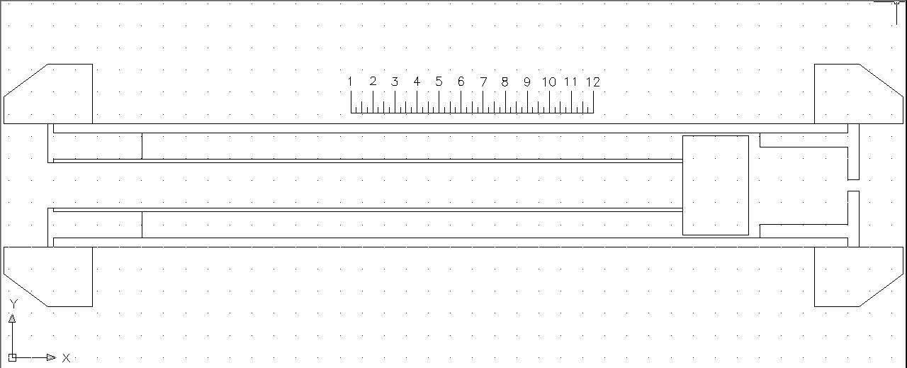

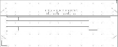

This is the design.
This is the design.
This is what the design is after.

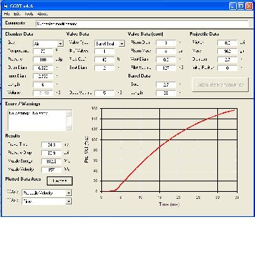

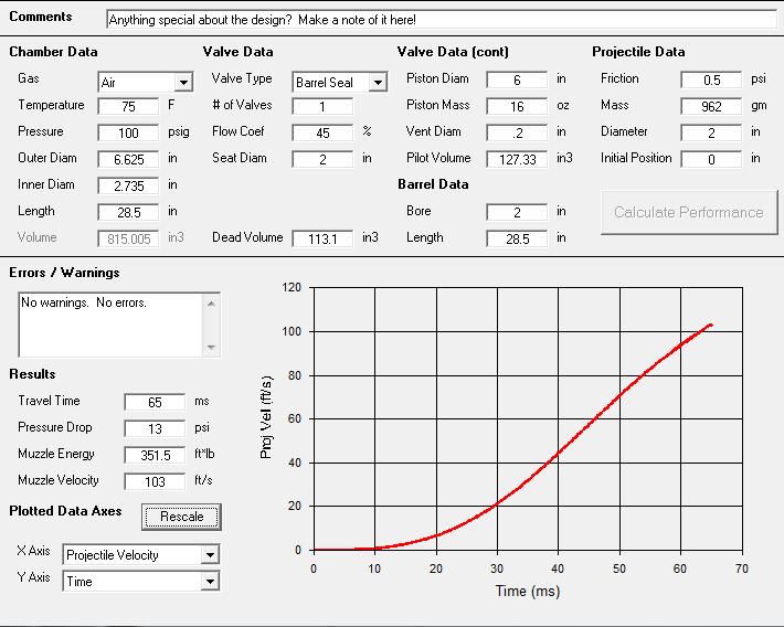

The GGDT estimate. It gives me a range of around 300 ft. It seems appropriate seeing as it will be shot at a football game.

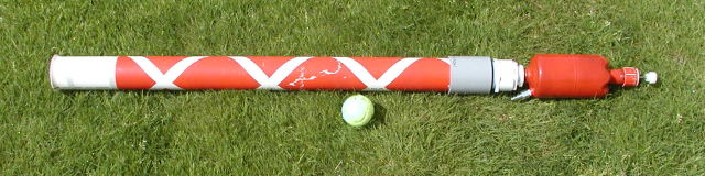

TB or T shirt barrel
Tennis ball barrel1.jpg (36.58 KiB) Viewed 8117 times

I took a good look at your GGDT. The little cannon above outperforms that cannon on 100 PSI. Using the same shirt weight, the larger barrel and smaller valve provides a higher launch speed.
I think if you figure out how to eliminate the huge dead space, things will work better. Lighter pistons open faster. Are you sure that dead space is really that big?

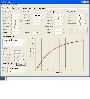

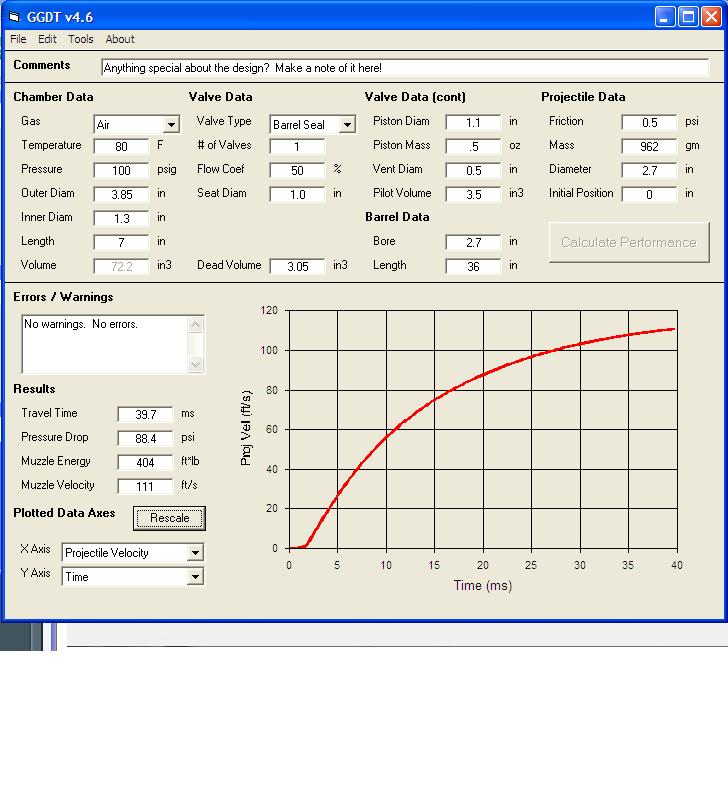

GGDT below shows a more powerful launch using about 10% of the air volume. If you want multi shots, work on effeciency and gas consumption per shot. I could launch 100 shirts with the same supply you use to launch 10. My actual chamber is smaller than shown. I used round numbers for size. I don't have the actual size at work.

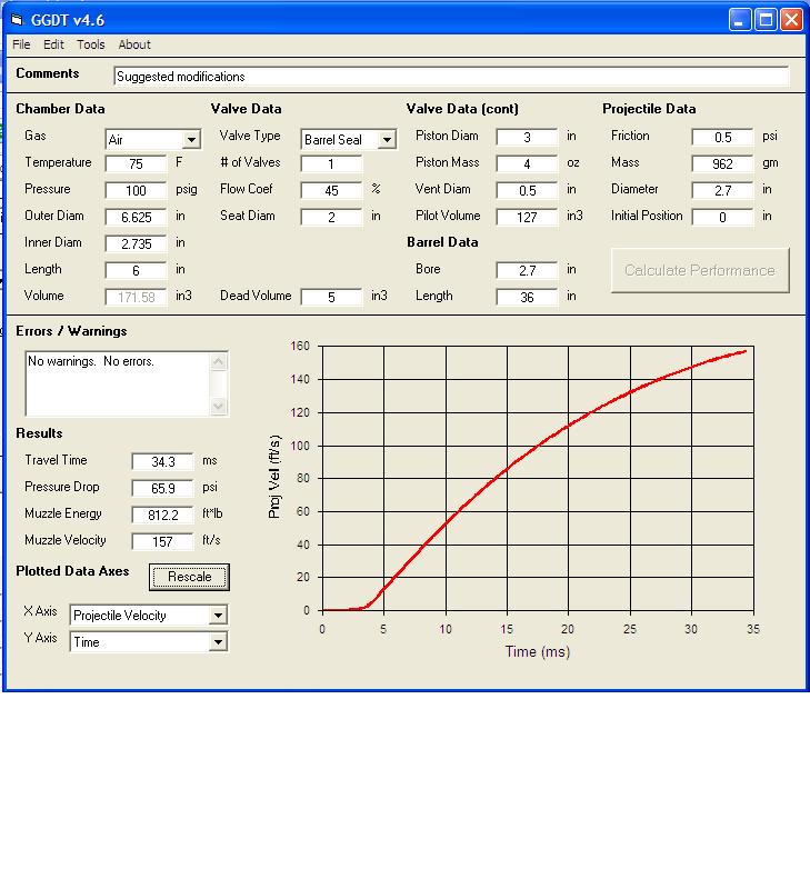

I took the liberty of modifying your design and plugging the numbers into GGDT. This mod will use less than 1/5th the air per shot, add 50 FPS to the shirt and cut the KE in the piston down to 1/4 so the possibility of breakage is much less. I enlarged the barrel so the cross section on the shirt is much better for the air launch effeciency and better flight. Overall this reduced the cost. A faux chamber can be added from a form tube for cosmetics if desired.
@ spuddytyrant; The full size cannon used in the contest was able to tag the retired numbers above the 300 section of the Rose Garden Arena in Portland OR on just 35 PSI. :D
GGDT screen shot. Small shirt launch tube on the small QDV launcher.
Design modified for a 6 inch long coaxial chamber, larger barrel, and smaller valve.  Excess dead space is eliminated.  Shirt can park close to the valve.
