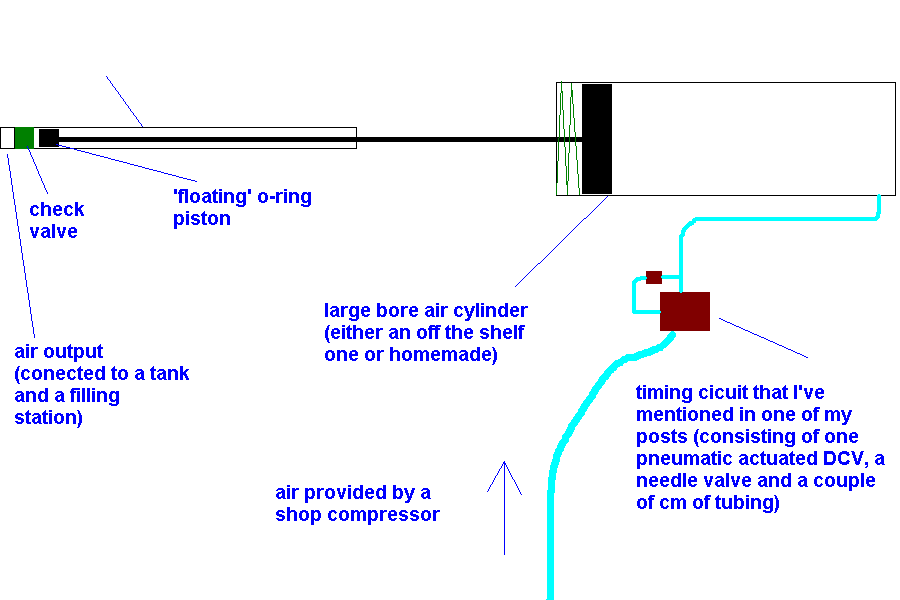

- homemade pressure amplifier.PNG (22.24 KiB) Viewed 3543 times
Pressure amplifiers work by using a large duplex piston with low pressure ( your lp air) to move a smaller piston which is supplied by the same air pressure. The larger surface on the driving piston allows it to push the smaller piston to a much greater pressure ( Pressure = Force (lbs) x area).
The discharge from the larger pistons goes into the intake of the smaller pistons and some is bled off with an upstream regulator or blow off valve in some cases. It cycles like a locomotive piston arrangement, so you 'pump' to a higher pressure using the supply air. There doesn't seem to be any reason why you couldn't cascade these to achieve even higher pressures unless the mechanism isn't made for it.

A pressure multiplier is an idea I have toyed with for a while. They seem expensive to buy but cheap to build if one has a lathe. I know Ragnarok has an idea for a mech. for these.
Really the problem is that since there is no fly wheel to push the piston back you need to make a mechanism todo so, that would most probably be the trickiest part, esp. if you want to cost down and pressures reasonably high.
Another question is how efficient they are, after all to get the piston back into it's place one needs to relieve the pressure on the big bore side, or over come it, doing this without venting may provide tricky.
Anyway, i think a pressure multiplier(PM from now on) is a better idea than a multi-stage pump, as a DIY source of HPA.

yo can either useReally the problem is that since there is no fly wheel to push the piston back you need to make a mechanism to do so
2 DCV valves that would switch the air flow when the air cylinder extends and retracts
or just use a timing circuit ( fully pneumatic circuit )
also I don't think there is any need for machining... it might be useful to build the check valve and maybe the piston of hte pump... but you might as well use a ready made PCP pump

meh, a pcp pump is 200-400$, the stock i would need to make that is under 100$.
