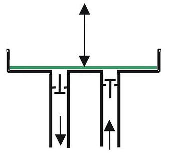

To reduce the surface area on the membrane, a flat plate could be attached similar to this.
Still working on the idea myself, but thought I'd pitch it...

From this:
To this:
inonickname
Posts: 2606
So the function is the same as a piston compressor, except that the piston is supported by a flexible material. It would probably still be difficult to keep dead space low, unless there was a seal around the solid disc. In that respect, it would be a piston valve with a short stroke.

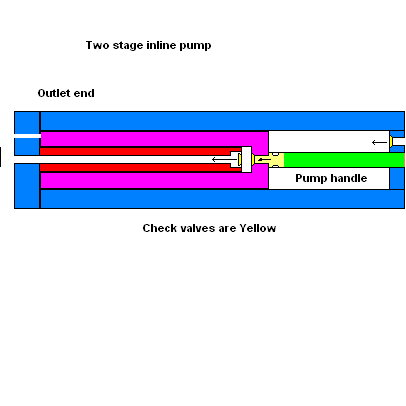

On the subject of commercial PCP pumps, does anyone have a diagram of a multi stage PCP pump? I understand the function of a multistage pump, though I can't quite figure how to integrate it into a single cylinder.
kenbo0422
Posts: 201
Joined: Mon Oct 06, 2008 7:33 am
Location: East Tennessee
A tube with a thick wall inside a cylinder. The tube is blocked on one end, with a check valve. The other end is plugged with a rod... Well, look at the drawing...
2 stage inline pump.PNG (6.36 KiB) Viewed 8048 times
