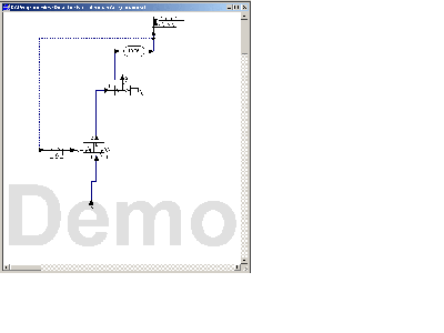

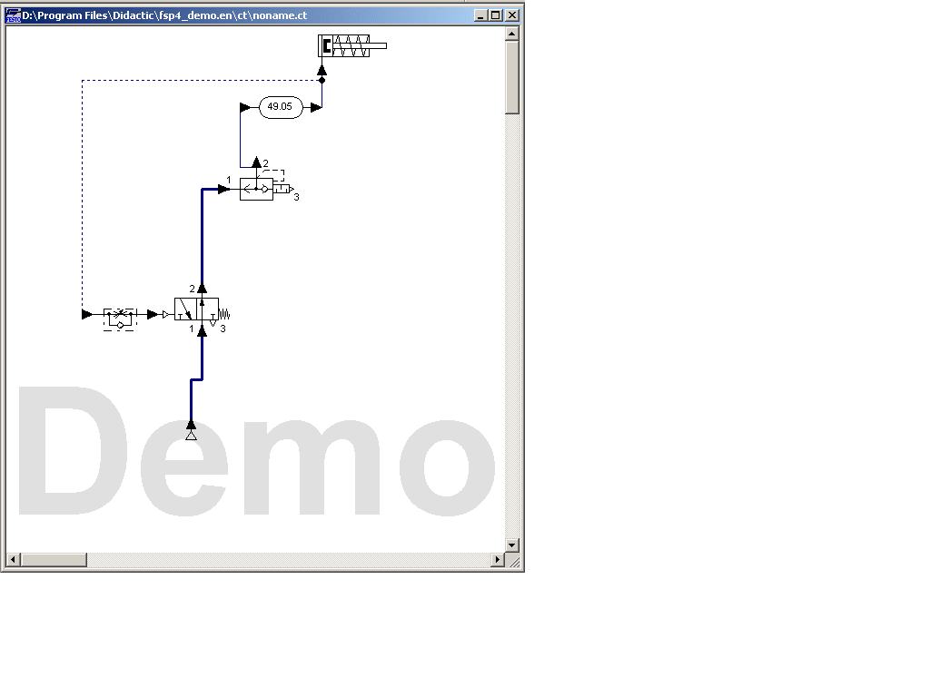

hmm now I am lost...I really didn't dig the uninterrupted input to the pilot
anyway... I think that I could have explained it better back then... so I made this animation of what it looks like in fluidsim (that thing actually simulates it... you can see the direction of flow, pressure and it does a lot more than that)

I was referring to qevs with pop offs, man that circuit is kinda confusing, but I already understood it from the description, which is more clear then that diagram
