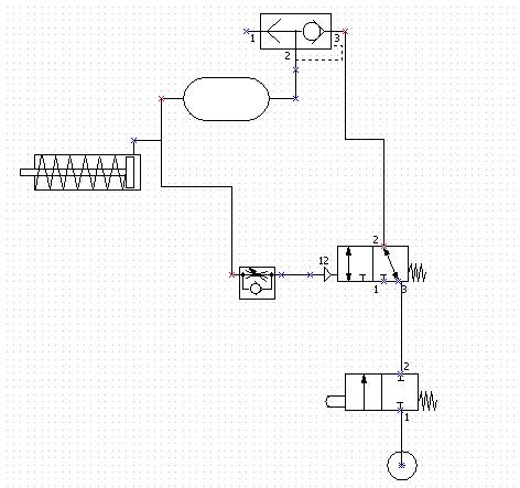

- this is the diagram I posted in brtrettel's thread... as you can see the design has one serious flaw. The valve, QEV and the piloting port of the valve are all joined together in one place via a T. Naturally, this will result in dead space that will hamper performance
- fullautoQEV+aircylinder.png (6.27 KiB) Viewed 17726 times
- it's a revised version of the design I proposed a couple of months ago in brtrettel's thread. As you can see the pilot port of the valve is attached to the tank..
in this way I can join the QEV and the valve directly via just a reduction nipple
(if it was attached via a T joining the QEV, the valve and its pilot port together, as it was in the original diagram, there would be more pilot volume which could hamper performance...
I made a mistake in this diagram but I corrected it. The air supply was connected to the port that was normally closed but it has to be open so that the air can flow through the valve to fill the gun and then switch/actuate the spool inside the valve...sorry about that but I missed that
IMPORTANT - READ IT IF YOU WANT TO BUILD A SIMILAR CIRCUIT YOURSELF
also have a close look at the diagram of the valve itself.... the arrows are in both directions... so it is both a normally open valve and a normally closed valve. You can change its function by connecting air supply to a port that is normally closed or normally open
the valve I bought first couldn't be used to build this circuit as it was only a NC valve
I made a similar mistake earlier... lol you never stop learning
so just MAKE SURE that the valve you buy is a NO valve or one that can be used as both NO and NC valve - revisedrevised.jpg (32.73 KiB) Viewed 17378 times

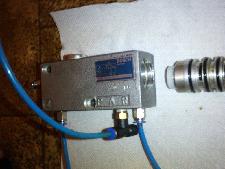

today I got the valve but so far I couldn't get it to cycle properly...
the valve works perfectly as a delay valve (so for example I can use it to extent the air cylinder after 0 - 10 second after supplying air to the valve; there is also one port that can be used to expand the chamber and thus get even longer delay)...

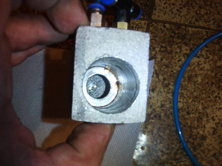

as you can see the valve is really large and it has a really interesting design (I've dissembled the valve to find out what the problem is and out of curiosity)
of course there are smaller delay valves out there - for example clippard's PV-1 (p. 165 in their catalogue... it's like.. hmm 4-5 times as small as the one I have).
now... why it doesn't work the way it should...
the circuit doesn't work because the valve stops in between one position and the other... maybe I'll just say what happens....
air is supplied to port R (see pics) and it flows both to the pilot port and to the part I want to pressurise (I've tested it both on a QEV gun and an air cylinder).... after a set time delay the valve almost switches... some air leaks through both ports (A and P)
any ideas why does it happen? and how to fix it?
also, isn't it that air should be always supplied to port marked as P ?
I think that might be a problem as air source acts on the bottom side of the spool when it is supplied via port R
well anyway if you have any ideas why it doesn't work I would appreciated if you post them...
I am 100% sure that a timer circuit can be built with two such valves but obviously I would preffer to get it to work with just one valve as having to use two increases costs, size and complexity...

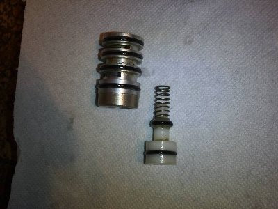

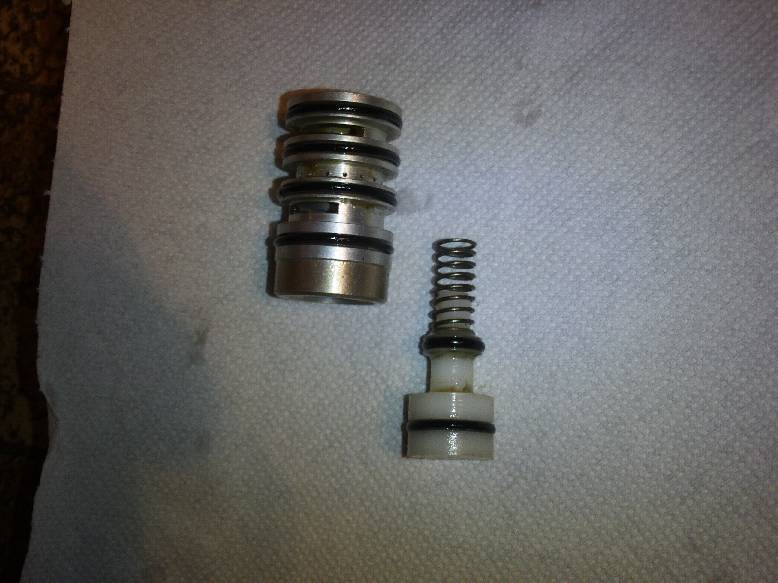

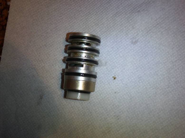

- notice that it is a sort of 'two spools design'... there is outer part and the inner part... the inner spool faces the pilot side and it's pressed by air supplied to the pilot port (then it gets via a needle valve and the 'cavity')
the outer spool doesn't move so it's there only to create a seal between the inner spool and the body of the valve
- inside of the valve... the cavity that you can see at the bottom increases the time delay... there is one plugged port on it's side that can be used to increase its volume and thus time delay
the two small holes holes at teh bottom are connected with a needle valve and a check valve (air can flow freely out of the cavity but when it enters it flow is restricted)

it works!!! muhahahahaha!!
today I was trying to get this thing the circuit to work when this arrived...
well I bought it just in case the circuit won't work with just one valve... as you can see it's just a 3 way air piloted valve (not a proper time delay valve as it doesn't have an inbuilt flow restricting orifice/needle valve; also as yo u can see it's pretty old - it was produced in early 1990's in poland)
well guess what.. it does work with it.. no need to add more valves
.. I quickly built the circuit with it and supplied air to it... and it works!! at first the cycle time was way to high (sounded like 30 - 50hz to me)... unfortunately, I don't have a needle valve so instead I used 15m of 4X2mm poly amide tubing to cause air restriction and now I get about 1.5hz cycle... so this thing is fully adjustable
my guess is that BOSCH 0820215003 valve didn't work the way it should because its construction can only accept air via port 'P'

I had some time today so I quickly put this thing together...
just to clarify:
this valve is a 5 way valve so it's bigger than it should be and there are way more tubing&fittings there than you really need... also the pressure used here was probably around 50 psi (lol that was shot at 4AM in my basement so you can guess why)
notice that the valve isn't even directly attached to the pilot side of the QEV.. instead there is a couple of cm of tubing between it and it's attached to the 3 way valve that's already on the gun
also I realized that I wrote way too much text in this thread which made it seem more complicated than it really is
so just to summarize.... this whole design comes down to:
1. get an air actuated 3 way valve and attach it to the pilot side of the QEV
2. get a needle valve and connect it with the piloting port of the 3 way valve
3. join the chamber side of your gun with the needle valve (which is already attached to the 3 way valve
ohh BTW I just put a 1/8" QEV on the piloting side of the MKIII and all I can say is... damn this works the way it should and helps a lot
also I found a way to attach the cam directly to the gun... lol pneumatic version of the land warrior...
hmm I wonder how would it work at longer ranges?
