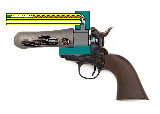

It will if you have a double action trigger. Can you get a revolver cap gun? If so you could conceivably cut it up and have it hammering on the inflator stem (the part under the trigger that I'm holding above), that will give you a burst of gas per trigger pull that would work great with a tee magazine. It would probably not be that pretty, but it would workit wont be semi auto with a hammer valve either

Here's how it looks like in my head:django wrote:Ive got an old 357 Blank gun( metal), might be able to use it?,I'll try get a pic up 8)

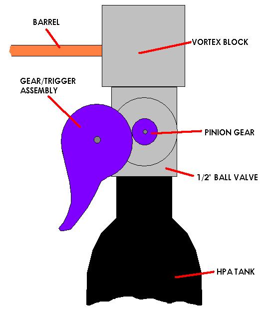

I was thinking about something like the attached diagram, ball valve fed HPA strafer... with the ball valve handle replaced with a pinion gear, and a larger gear attached to the trigger, meaning that for a small movement of the trigger there will be a larger movement of the valve. It also means that the trigger will require a lot more force to open (plus the return spring it will need) but the gain in performance should be worthwhile. I have a couple of 1/4" and 1/8" ball valves that have remarkably low friction (in fact I'm saving one of the latter for the sentry gun) but I like the overkill use of a 1/2" valve, plus the ASA threads on the tank fit nicely in 1/2" BSP (as used in the HPA Rattlesnake)
