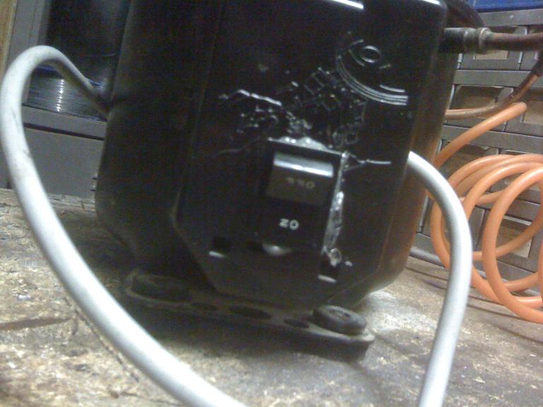

i just check the cable in the red its has 4 wires in it black blue green/yellow and purple
i put black blue to gethere nothing happend
blue and purple and my house circuit breaker cut out
the blue is hot and black is nutale i dont know what to do with the earth or purple
fridge compressor help needed

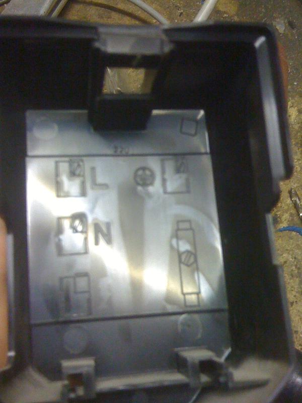

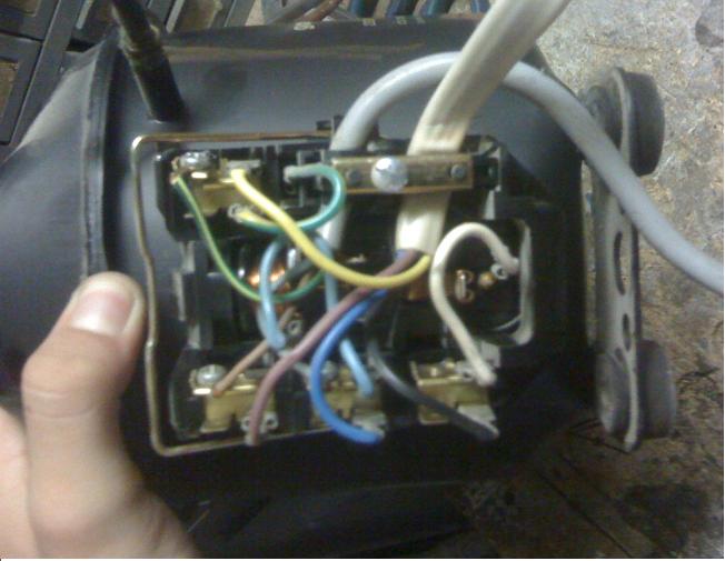

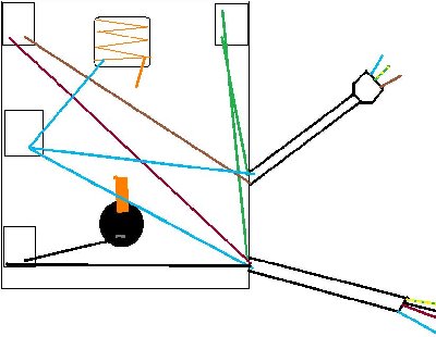

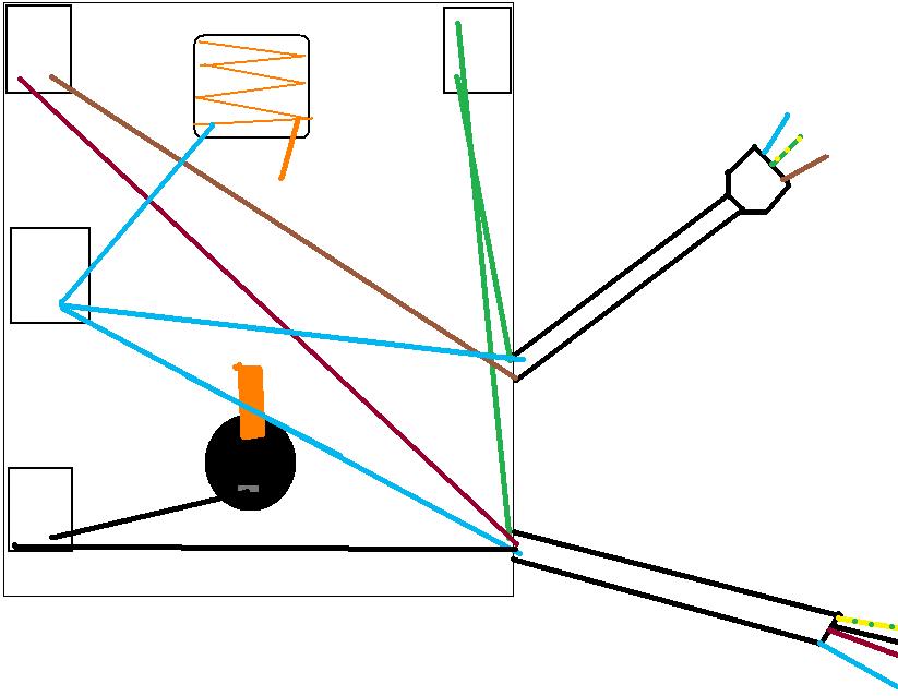

i took new pics and made a diagram
on the top is says
5.5k11 google tells me thats the relay
220 dont know about same as 87338
on the top is says

that's what I thought...
blue is probably NEUTRAL
brown/red is HOT
green/yellow is GROUND
you've got to put an on/off switch between RED and BLACK wire in that cable
once the two are connected the circuit is closed and the compressor should start
also you can also use BLUE and RED from that cable to power a fan if you want to... though keep in mind that 220V AC so you need a fan like that too
if you don't need it now just make sure the other wires are insulated (so they don't touch each other)
if it doesn't work then either something is wrong with the wiring (not likely) or one of the relays is broken or the compressor itself is broken

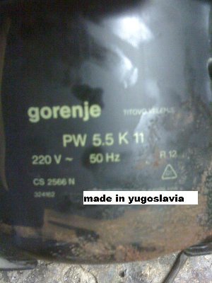

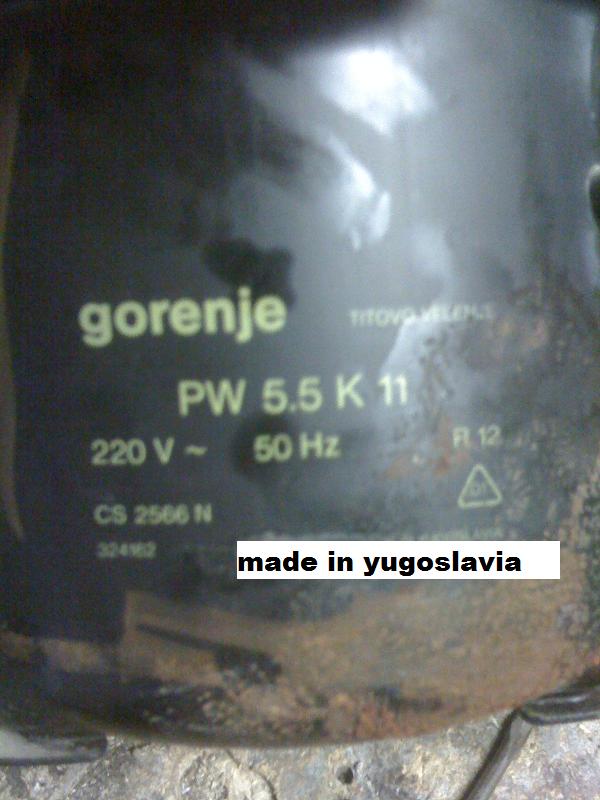

The compressor is a gorenje model PW 5.5K11 running on 220vac 50hz and had R12 as the Freon type.-_- wrote: i took new pics and made a diagram
on the top is says
I do not see a start/run cap anywhere? Where is it?
Do you know what brand the refrigerator was?
My best guess would be to connect the violet to black of the 4 conductor cable. This would act like the thermostat switch.
Can you get a better picture of the "box" wiring? Better focus or better camera.
The 3-conductor grey cable was the original power plug correct?
My best guess is to connect the black and violet together. This would simulate the thermostat switch. You could use a switch between those wires for On-Off control.

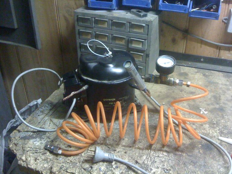

awwwww yeah i got it to work it was the purple and brown wire il get pics up when i put the swich and a nice box for it.
i got 1/2 inch compression fitting and just layered hose on the pipe till it fit tight and i cant pull it off with the fridge camped down and winch the to the compression fitting, snapped 600 pound rope before the fitting moved
start/run cap is the copper thing in the pic img_0058 its behind the wire

hmm I can't even find them in the diagram... are you sure about it, I'd say it's almost certain that you had to connect the red/brown wire to black one ??was the purple and brown wire

yea its is purple/brown to the black my mistake

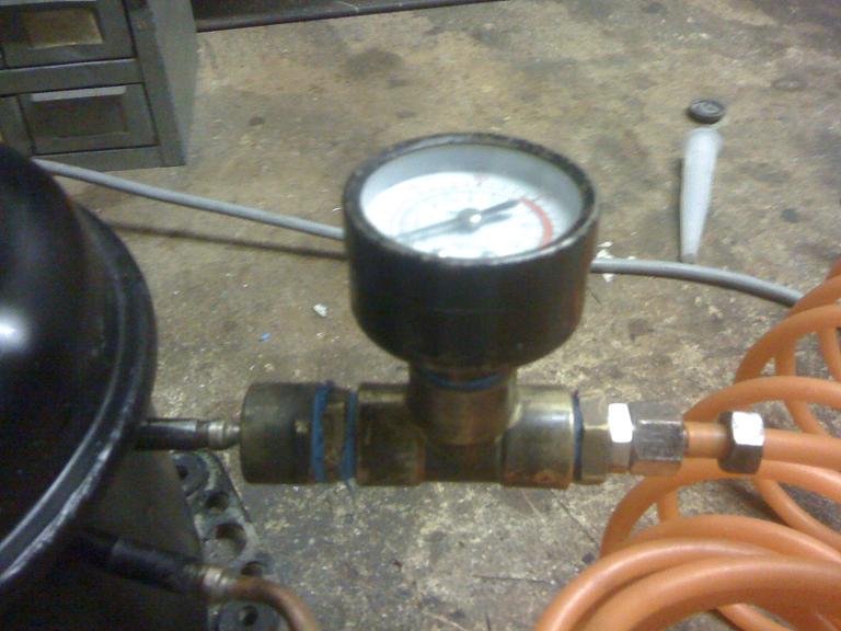

and holy crap it has low flow took like 7 min to fill 1l FE to 90 psi.
i put 90psi in the input it zoomed to 180 in 5 sec i need a 350+ gage ill look at a welding shop for it
i blow up coke bottles today well three 2l bottles they pop at 140-150
1.25l ones blow at 160-165, ill get some 500ml ones tomoz

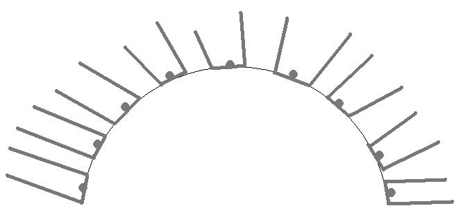

i need a fan for it too got hot in 7min solid run, ill try make a alu heat sink, would it work if i make a bunch of U shaped bits and bolt it to a round plate bent to fit the compressor and is perforated aluminum sheet good for it or only flat sheet.
- something like this
- heat sink.jpg (16.28 KiB) Viewed 3951 times

you must have some leaks then... normally it's almost 10 times thatand holy crap it has low flow took like 7 min to fill 1l FE to 90 psi
somehow it didn't help much, probably becasue I glued them to the casing

edit: added switch and put a gage and hose tho i need a 350+ gage im going to get one soon.
