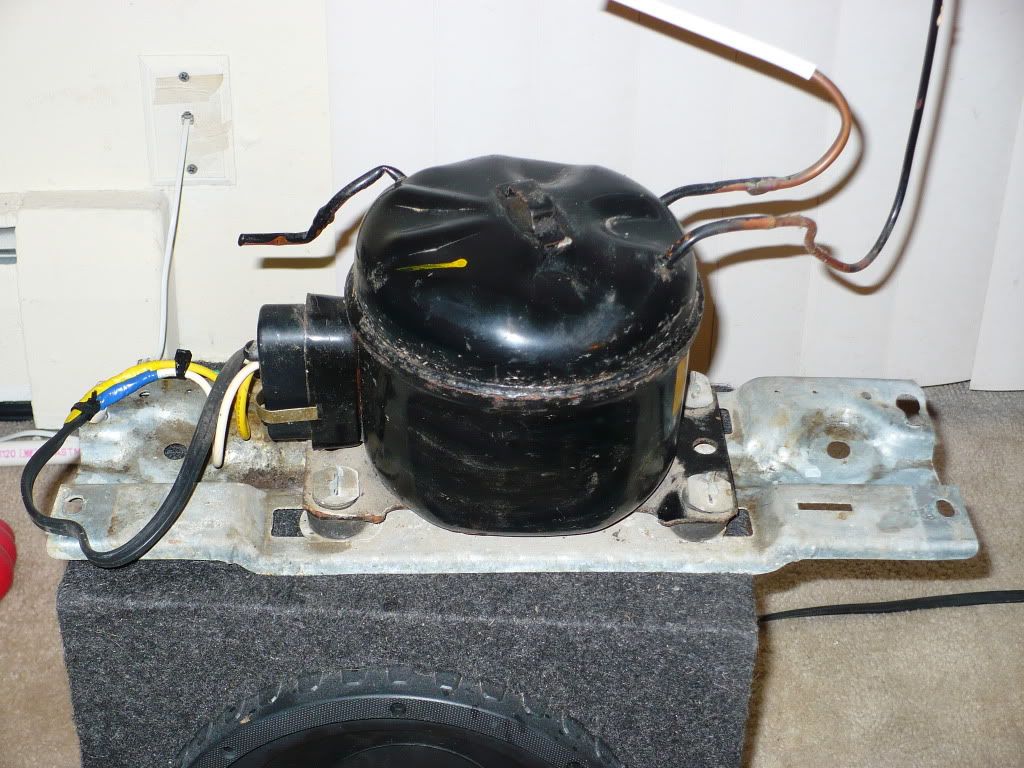

this is the one that i yanked out of a mini fridge. I think you guys are referring to those mini thermoelectric fridges. its not hard to tell what kind it is, just look behind it!
<a href="http://s215.photobucket.com/albums/cc33 ... 000535.jpg" target="_blank"><img src="http://i215.photobucket.com/albums/cc33 ... 000535.jpg" border="0" alt="Photobucket"></a>
