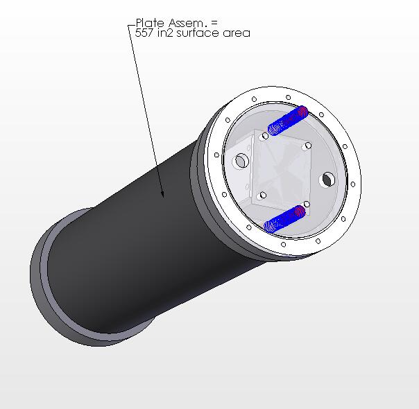

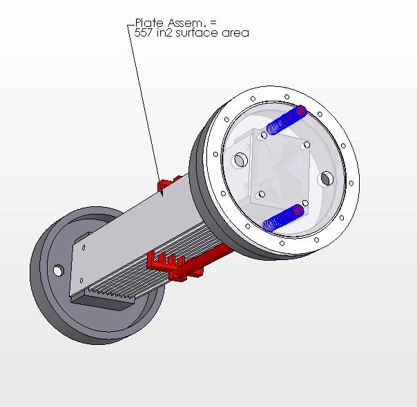

This is a unit I built 2 years ago. It's about the same size and configuration as yours but, it has 6 positive plates, 6 negative plates and zero neutral plates. It produces 3 liters per minute at 12volts / 13amps and produces very little heat. The electrolyte never boils.

I am not sure what a nuteral plate is.
A neutral plate is one that's not connected to + or -. They just ride along in the case as dead plates. Some builders think neutral plates work miracles when in fact....they do nothing. Plate spacing is very important for gas production at lower amps. Try to keep your plates at a max separation of .050"
