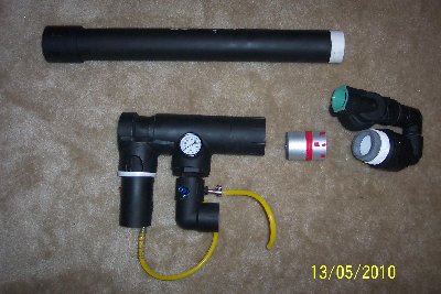

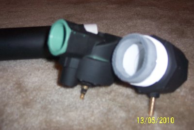

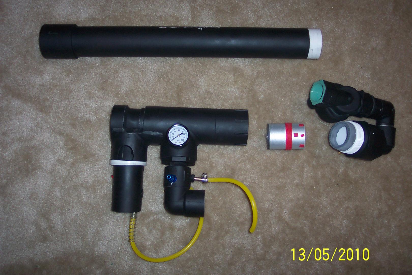

Well Yes Colonel clemsonguy1125,
It is a sprinkler valve. It turns out that the $11 dollar valve does a better job than the $15 valve. I could have taken a beter picture, but i figured if the looker knew what it was, they at least knew how it worked.
With the $11 valve, there is way less Humm/moan and more POP from the muzzel, I like it!!!!! I used the 1" version.

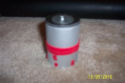

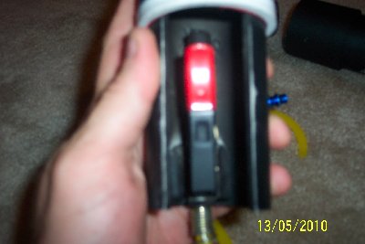

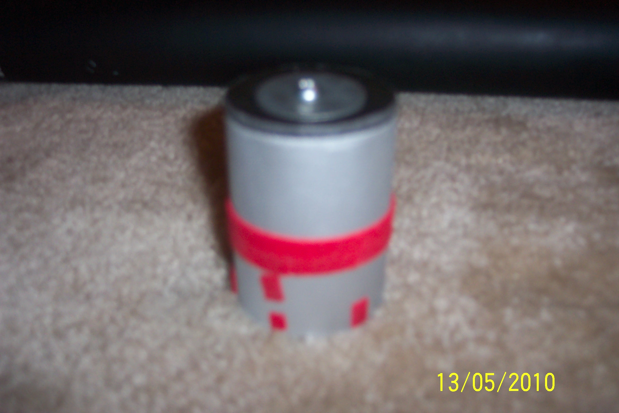

By Request,
Here are some close ups of the internals.
For the bumper, I went to the dollar store, and bought a set of flip-flops. I shaped it with a dremal tool, and used JB quick to attach it. 200+ shots zero failure.
The felt on the piston, allows it to slide, no lube, and provides a minor seal to actuate it back to the forward possition. Don't judge,,,, it works. 200+ shots with zero failures.
Everyone have fun, and keep it safe. Think about it before you do it.
