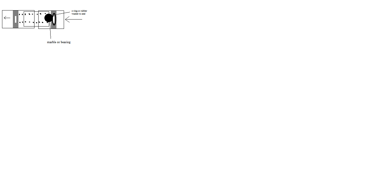

why dont you just make the simple kind in a coupling... pic adding in a minute.

you can make one for under 3 bucks:
gray square things are washers, left one for the spring to hold on and right one to secure the sealer
- check valve
- checkvalve.png (14.62 KiB) Viewed 3802 times

Most likely, you can use a rather strong spring and with a metal bearing and an o-ring, I can't see how it wouldn't.
That plan posted or something similar will hold thousands of pounds of psi. As long as the ball bearing is large enough so there is no way it can pop out the inlet hole it's not going anywhere. It's just like the system used for a beer keg or fountain drinks in restaurants.
The best thing to house the valve is a threaded fitting that steps down a size. There is a perfect ledge for the o-ring and seal surface to rest against.
An 1/8th-1/4 brass male fitting is my standard one way fill valve.
