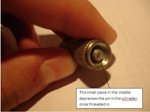

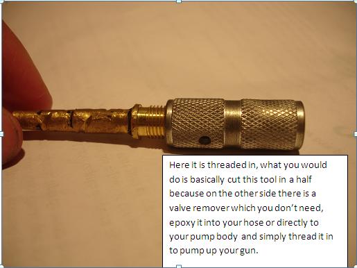

EDIT: A solution to this problem would be to buy a schrader tool that allows you to thread into a schrader and at the same time it depresses the pin. I'll post a pic once I'm done eating.
I am planning on operating at about 600 psi with the schrader checkvalve system. So if I just connect the schrader valve through the pump system without a pin, I will just get a pressure differential of +70 psi on the input side?
No no no, if you don't have a way of depressing the pin on the schrader, you're gonna have to pump to 70 psi or so (I think that's what it is) before you get air into your chamber. What I'm suggesting is buying a schrader tool that threads into your schrader head AND depresses the pin on it to allow air to go in automatically.

- Here it is threaded onto a schrader I'll be epoxying tonight (thus, the roughened up surface)
- Schrader pic 2.JPG (30.11 KiB) Viewed 5401 times
- Here is the schrader tool, on this side the tool threads onto the schrader and depresses the pin, on the other you have a valve core removal tool. You're only intrested in this side though.
- Schrader pic 1.JPG (19.07 KiB) Viewed 5401 times
