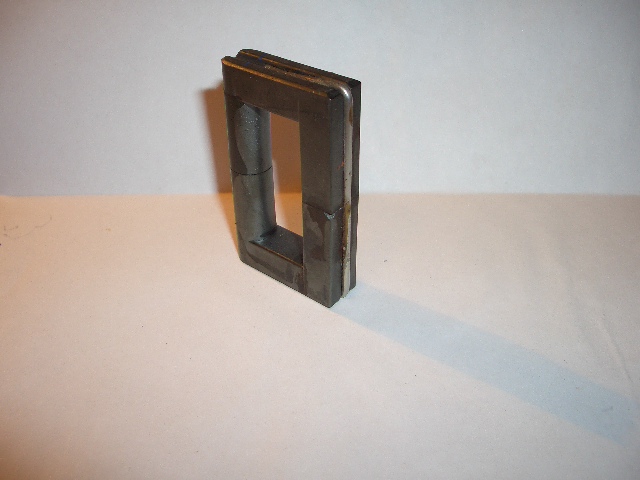

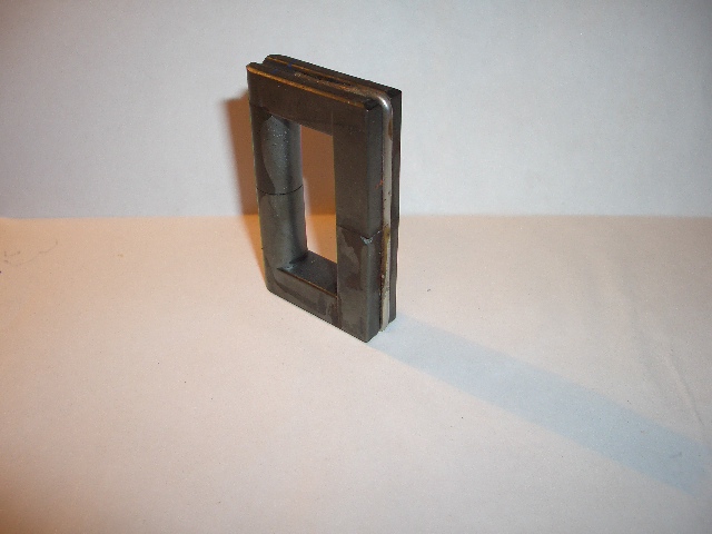

Fnord, I have been tinkering around with a flyback based ingition for a little bit and have access to almost anything related to coil winding. I have been unsucessful in using the existing windings in the flyback so I removed the core to give winding my own a shot. Have you found any sort of data on coil resistences, wire sizes etc? Any help you could provide would be greatley appreciated!
