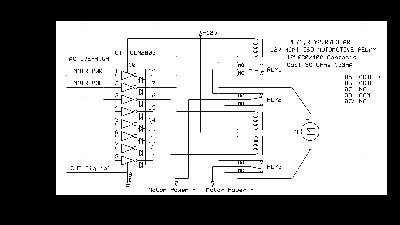

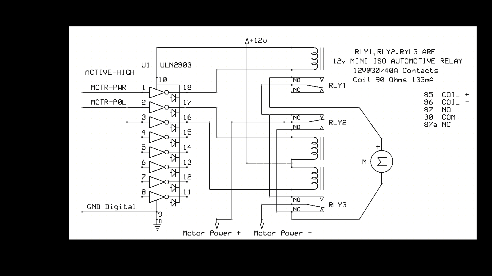

Here is a simple schematic for your reversing motor control.
Note that inductive loads have about a 30% of maximum resistive current in relay contact ratings.

Thanks for all the great info. That schematic seems like it should work well.
To answer a few questions, the power source is going to be a wheelchair battery, which is just a 12v deep cycle lead acid battery. The drill is a dc motor that runs at 9.6v. With no load on the motor, I measured a draw of between 3 and 4 amps, but under a load it would be higher.
There will be a set of normally closed sail switches (one at the upper limit of the door and one at the lower) that will cut the power to the relays that drive the motor when they are pressed, so that the door will stop in the right places.
