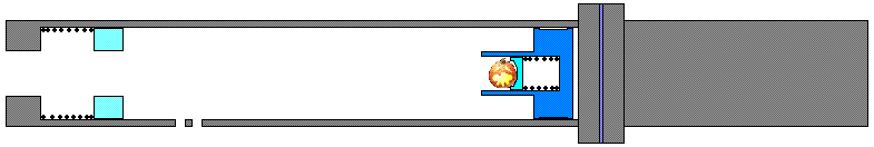

So assuming you've got a captive piston, couldn't you make something like a springloaded "pumpkin cushion" to act as a shock absorber and allow greater acceleration of the sabot at launch? The spring would probably also extend when the sabot is caught, returning a good portion of its energy to the pumpkin...

That would definitely make sense, here's how I would make it...saefroch wrote:So assuming you've got a captive piston, couldn't you make something like a springloaded "pumpkin cushion" to act as a shock absorber and allow greater acceleration of the sabot at launch? The spring would probably also extend when the sabot is caught, returning a good portion of its energy to the pumpkin...

So you're increasing the area of the barrel (and thus force on the sabot) by a factor of what now?
Dang, with a design like that, spudfiles should enter a build next year.
