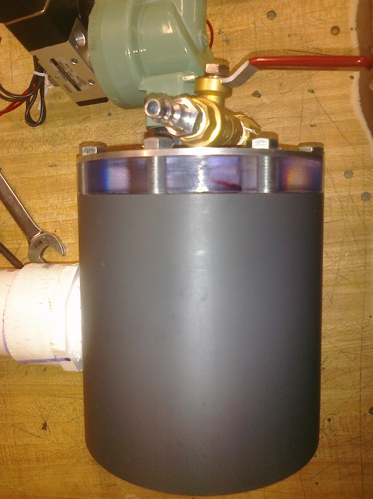

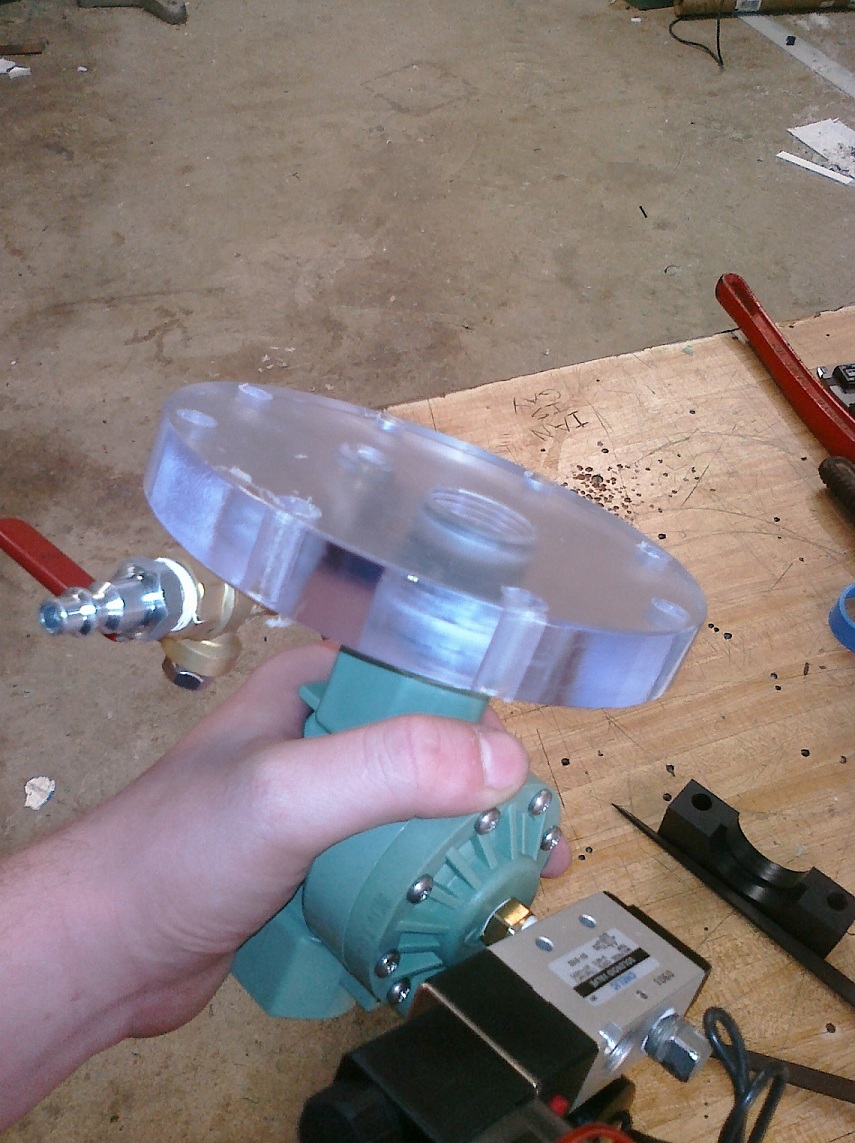

PVC piston valve in progress!
- Technician1002
- Posts: 5189
The bumper needs to deform while slowing the piston. Do you think polyurethane will compress well enough to do the job?
To be honest I'm not sure, Its very soft and, soft enough that i have to freeze it with dry ice before I machine it. but now I'm thinking i should use a more standard solution to it just to be safe, I'm not really concerned about the the valve itself breaking from the piston as the back is made of lexan over .800" thick, but I am worried that the piston itself will not hold up.

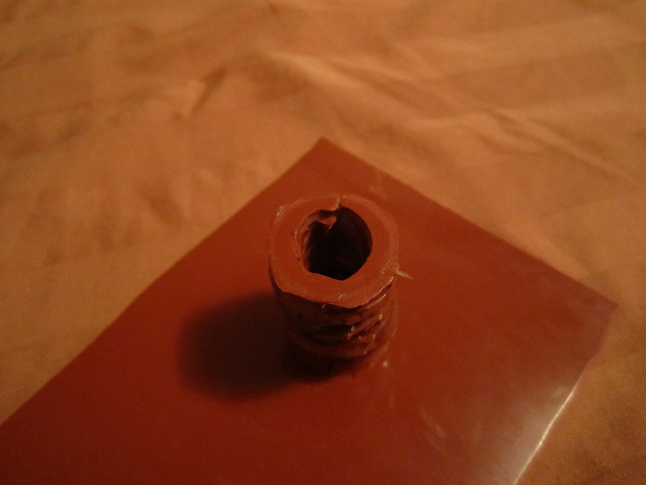

My solution is usually sheet rubber 1/4" thick or more (more for heavier and larger pistons). Multiple layers of 1/8" can be combined to get the thickness desired.

Rubber works if it is not filling the space completely. The rubber MUST be able to deform to function as a bumper. A doughnut around the pilot hole works as well as flat rubber on a corrigated surface. Rubber defoms to work as a bumper. As a solid flat surface, it is not very compressable and would work as well as a block of ice.

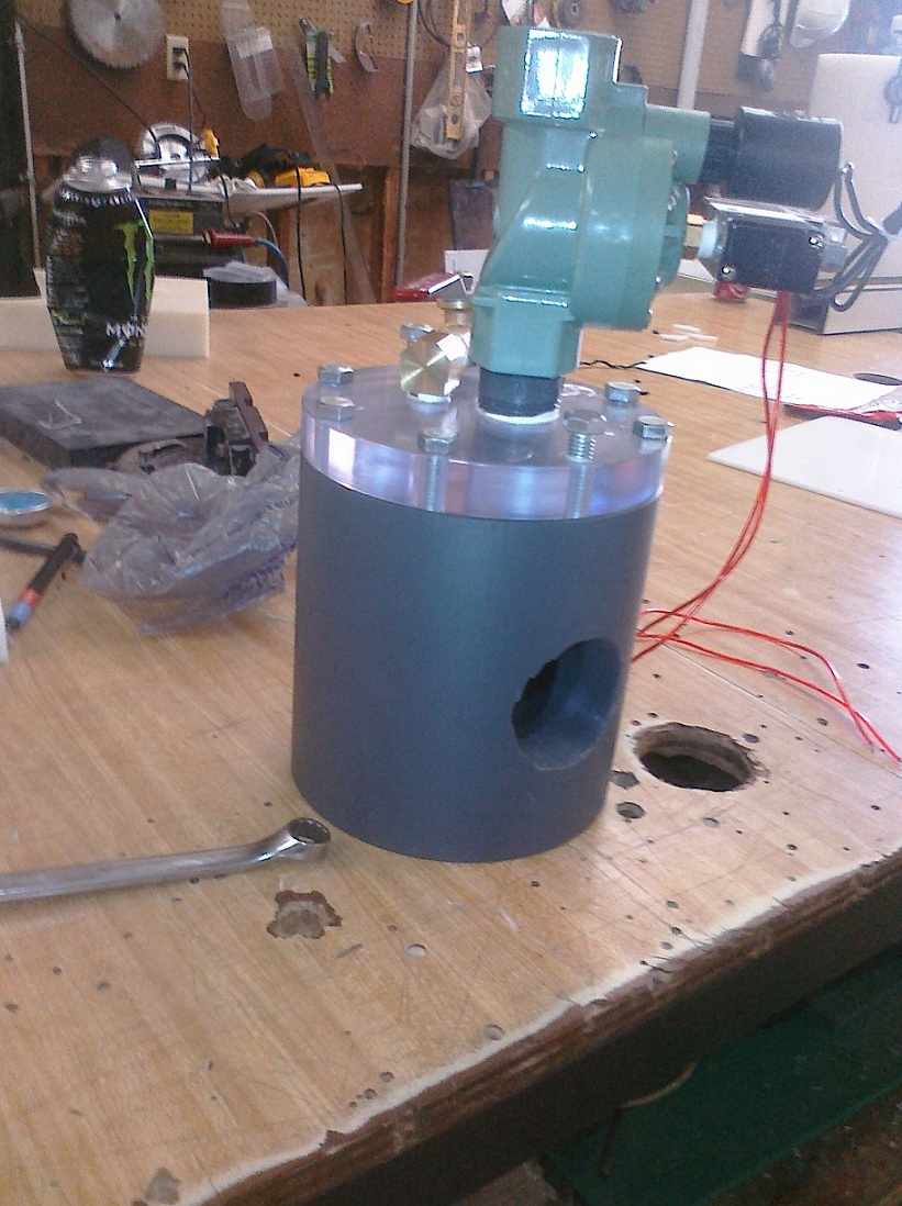

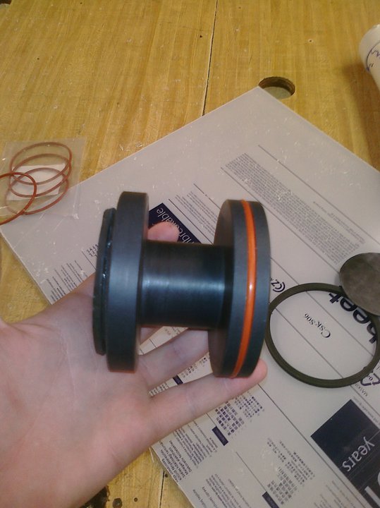

got it all put together today minus the bumper . attempted a small test fire but it would all go out the exhaust valve and the piston would only move back ~1/16" or so, im not sure whats going on there, I may have to make a new piston with orings and a check valve.
- mark.f
- Sergeant Major 4
- Posts: 3643
- Location: The Big Steezy
- Has thanked: 58 times
- Been thanked: 62 times
Where the piston seals against, is there a raised lip slightly larger than your outlet port ID, or does the piston sit flat against the end of the valve casing? (i.e. the piston's front is completely in contact with the valve housing with no surface area for air pressure to act against.)
I think this is your problem. It should be as simple as adding a lip for the piston to seal against.

Very nice. I'm glad you ignored my retarded and difficult suggestion and added the lip to the piston instead of the valve housing. Never thought of that.
