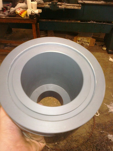

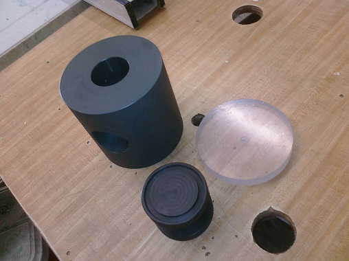

Its been a while, but I decided its a good time to get back into this hobby, so today I started machining a piston valve out of PVC and the piston out of nylatron. the bore is 3.5" and the ports are 2" ntp. I am making a removable back out of 1/2" polycarbonate, and I am going to pilot it with a one inch sprinkler valve.
I'm very excited!
PVC piston valve in progress!

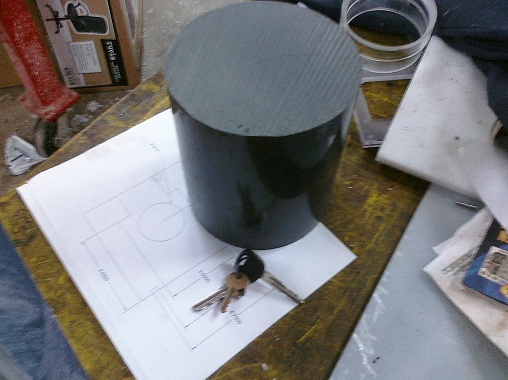

It does seem like it's going to be excessively heavy, will you be hollowing it out somehow, or forming it into a cup shape?mark.f wrote:you're machining the whole thing out of a gigantic chunk of PVC type I stock?

He did say the valve body was going to be pvc. So yes, I would hope he would be hollowing it outwill you be hollowing it out somehow
Unless Jack is being sarcastic of course.....
You should be excited. This thing is going to be very nice. It will also look very VERY slick since it is being machined, as opposed to being maed from plumbing fittings.

I think he was asking about hollowing out the piston...

Image names clue us in a lot. The component up top was machined from the stock in the bottom picture, most likely, I was just wanting a few more specifications.

Thats a probable probability. I saw "PVC" and assumed valve body, since in the original post, the author stated his piston would be machined from nylatron (the plastic cousin of Megatron).
