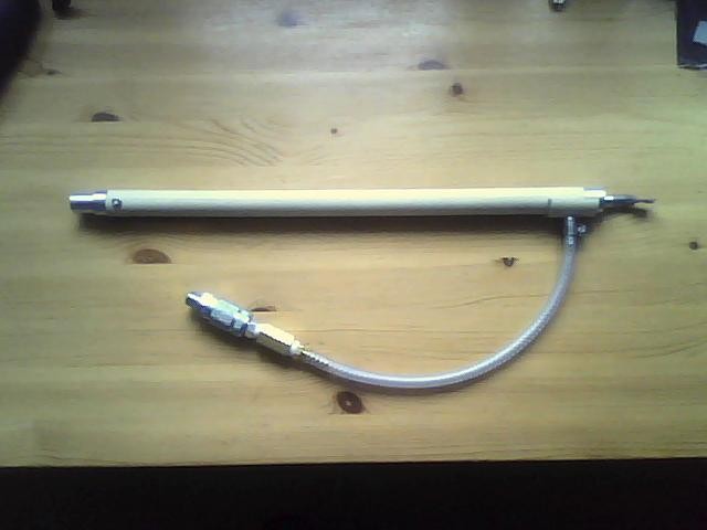

Here is some progress :
The yellopw thingy is the no-return valve and Q.D.
The CPVC pipe is the air chamber, barrel to the left, trigger to the right (the trigger will be rigged to be installed to the left).
The pump is the only thing left to do. The seal right now is total at lung pressure, so everything is alright !

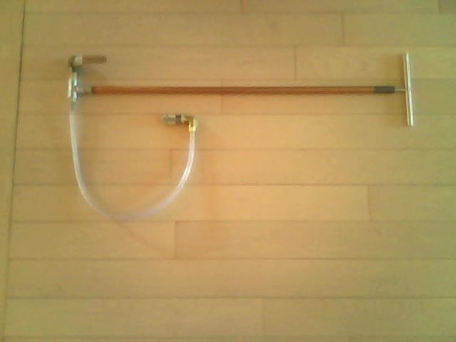

The pump works perfectly, but I can say as much of the QDV ...
The piston head won't seal, and the o-ring slide lets air slip trough. It should not be hard to repair tough, it will only take time.
Here's Teh pump :
warhead052
Posts: 1769
Nice job. It looks awesome, does the ball valve help?
