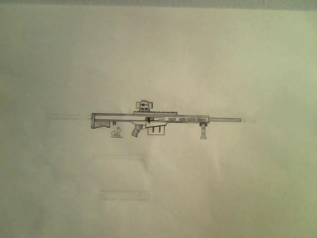

I have to make a M107 replica that fires caliber .545 marbles. I tought long about it and then i just found the perfect design.
As you can see in the diagram, its an inline Quick Dump Valve with a cartridge-bolt-action directly rattached to it, making the whole perfectly streamline to be fitted inside the M107 body.
Wether to use CPVC or copper for the air chamber is not yet decided, since I have problems drilling clean holes in copper.
My apologies for the poor image quality and lightning, they were taken by my laptop's webcam.
For the machining part, it won't be a problem, since i've managed much harder (i am even surprised by the extreme simplicity of this design. The biggest part of the work will go into making a realistic body).
Some insight, maybe ?
M107 project

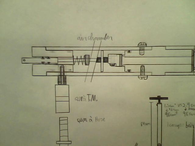

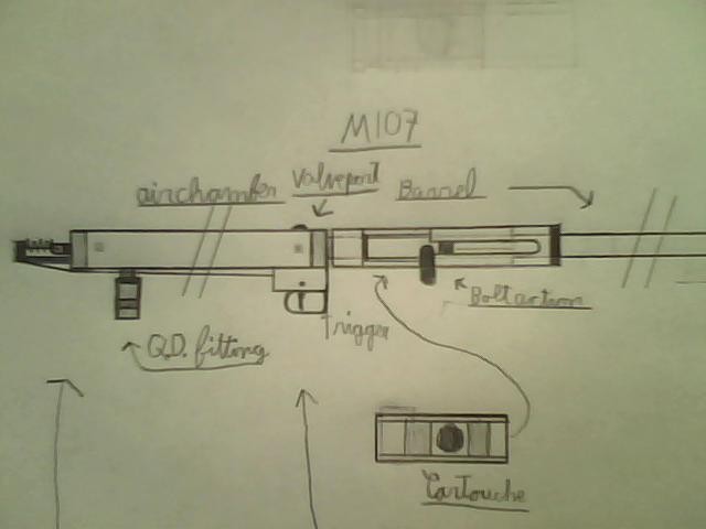

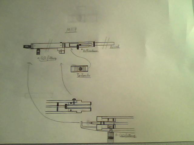

Have you tried to zoom in on the small drawing? It needs to be higher resolution and cropped to the subject. I can't see the detail to understand were the chamber is, the valve, and the loading port. All text is illegible. I tried to zoom in to see the detail and just got blurr.
I know.
Just imagine one of your QDV, but add a bolt action where the barrel connects to the air chamber.
The only reason of such a design is to make an inline valve.
If i still am not clear, tell me and I will go pick up the hd camera.
Edit: nvm i am going right now.
- Technician1002
- Posts: 5189
Much better. I can tell that thing in back is the Quick Disconnect. It uses a Cartrige for the projectile loading and it is not the QDV core. This is an exterior drawing so the valve core and ports in the chamber is not shown. Makes much more sense now.

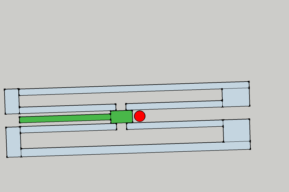

Here are the ready-to-machine plans.
And no Polandspud, it's a much simpler mechanism then the one you draw. you see the bit peeking out at the left of the gun ?
You pull it, and the valve opens, letting air into the barrel, wich is at the right.
The white ring behind the rubber seal does'nt block air, it's there to center the rod.
But it does'nt matter anyway, i am already ready to buy the missing parts.
Real machined aluminium should be easier to understand.

- Picture0024.jpg (33.29 KiB) Viewed 5625 times
- POLAND_SPUD
- Posts: 5402
Is it ?? you'd just have to drill one hole and turn the bolt on a lathe (to cut o-ring groves)it's a much simpler mechanism then the one you draw
Then just add a spring loaded bolt and a simple mechanical trigger... and voila! you've got a gun
It doesn't really suits my needs, since it's co-axial instead of inline. The barrel is cal .545, so making the airtank around it will making it even bigger, wich is not an option, as i want to integrate it in a stock.Is it ??
