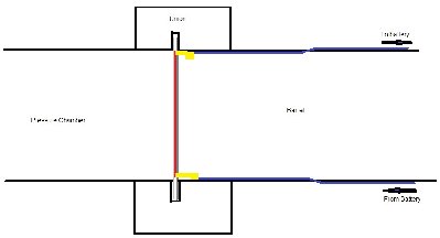

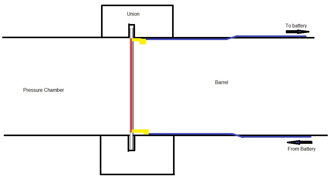

Here is my idea for the triggered burst disk. The Nichrome wire will be held to the mylar disk with duct tape, and the wire will be connected to the rest of the circuit using quick disconnects. The disconnects give a more rigid structure for easier connection.

I'd be more worried about the current it draws. The nichrome wire I have is 13Ω/m so for a 10cm length at 9v it would be attempting to draw ~6.9A. Don't expect the battery to last long. And as jack said, be very light on the trigger, you're pretty much shorting the battery.JDP12 wrote:JSR- what sort of battery can you use to heat that wire- what sort of voltage is required? This may have to lead to another prototype
That resistance is at what temperature? The temperature coefficient becomes very significant, because nichrome heats up quickly, and not much charge actually needs to be passed through it until it heats up enough to trigger the valve.3VIL G3NIUS wrote:I'd be more worried about the current it draws. The nichrome wire I have is 13Ω/m so for a 10cm length at 9v it would be attempting to draw ~6.9A. Don't expect the battery to last long. And as jack said, be very light on the trigger, you're pretty much shorting the battery.
About that picture: Leads inside the barrel? I'd be concerned they'd be torn off during a shot...
I will primarily firing those finned nerf howler footballs, as per my area's AT weapon regulations. The leads will only go an inch or two before passing through the barrel walls, and the rocket fins are about five inches long. The leads will also be secured to the inside of the barrel using some type of adhesive, maybe some of that liquid nails stuff.
