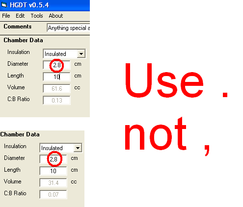

My calculation was as following:
(chamber length*(pi*r^2)=(10*(pi*1.4^2)
That makes the chamber volume 61 ml.
HGDT says the chamber volume is about 30 milliliters, wich one is right? :scratch:

Labtecpower wrote:My calculation was as following:
Damn Euro decimals ;)

ah, now I understand :D
thank you!

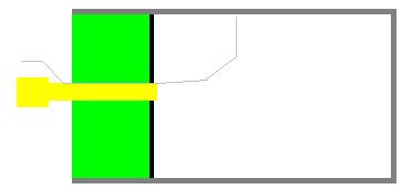

OMG I started to make a hybrid it looks almost exactly like yours and is 63ml chamber, how loud is your one? at 5x. All i need to do now is get a good igniter because my spark gap is about 1mm and i don't think i can close it up.

Crna Legija wrote:All i need to do now is get a good igniter because my spark gap is about 1mm and i don't think i can close it up.
Looking at the picture, it seems your electrode is too close to the schrader outside the launcher, so no matter how strong the ignitor is the spark will still perfer to arc externally at higher mixes.

Yeah it is aluminium, walls are 2.3mm. The epoxy plugs are 20mm thick and there are two pins going the whole width of the plugs.
jackssmirkingrevenge wrote:Looking at the picture, it seems your electrode is too close to the schrader outside the launcher, so no matter how strong the ignitor is the spark will still perfer to arc externally at higher mixes.
peace of wire is connected to the schrader and was use to hold the valve up while I casted. It also extends the spark gap to 1/3 the way in

piace of wire is connected to the schrader and was use to hold the valve up while I casted. It also extends the spark gap to 1/3 the way in
Ah ok, though it was the other way round and the gap was between wire and schrader.

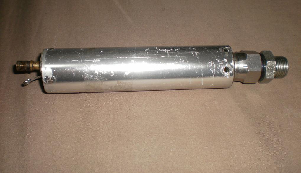

Second explosion in two days :D
The front connector decided to fail at a 9x mix. The bang was loud enough to make my ears ring under my ear muffs, but the reaction from my mom was more frightening :roll:
Luckily I have a stainless steel connector, wich should be able to survive the pressure. I used a burst disk with a 35 bar burst pressure.
You can see the connector in the picture above. I just need a way to connect the barrel.
