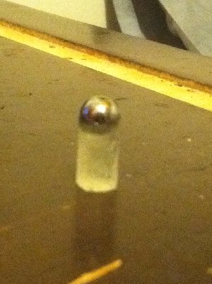

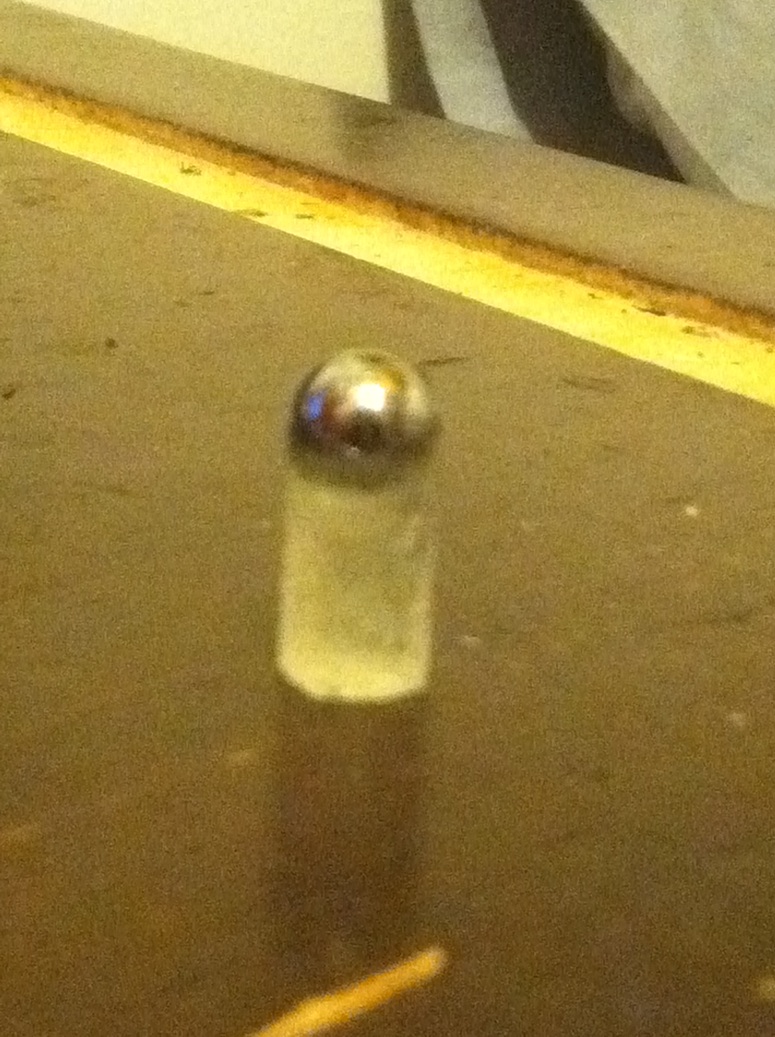

Started making actual projectiles today..
I'm sorry for the terrible quality of the picture I couldn't get it to focus on it to save my life.
It's pretty basic, just a short section of the barrel is lubed up, the ball bearing is dropped in and epoxy is poured into it.
Haven't test fired it yet, but it should give a good airtight seal and will be pretty easy to feed via magazine eventually.
Looks good
I'd be concerned about the BB breaking off on firing though if you haven't roughened the adhering surface.
it just broke off before even firing... so I will have to roughen the adhering surface of the Ball bearing for the next one.

I'd really rough it up..drill a hole if you can.. bastard cut file/grinder as well
... or just avoid using BBs altogether
