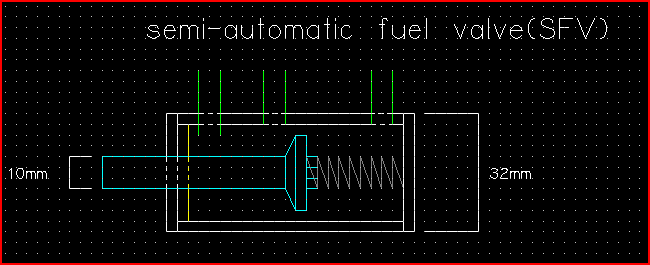

A few projects back I made a 3-way valve, There are two tanks. The main and the charge, the third is to the chamber. When unpressed the main and charge tank are connected, when you "fire" the valve the charge tank is disconnected from the maintank and connected with the chamber. This valve worked great, only the fueling is a problem for a semi-automatic.
GR.Tom
GR.Tom
- The 3-way desgin.
- semi-automatic fuel valve.PNG (11.05 KiB) Viewed 3675 times
