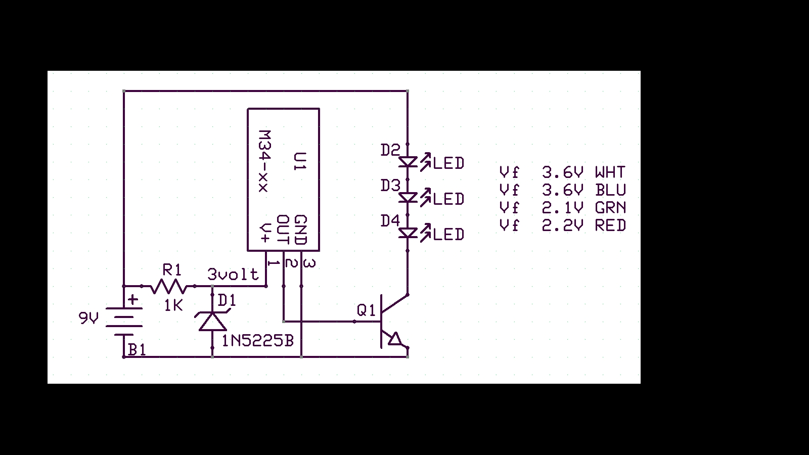

@al-xg
The circuit you linked to is not even a flashing circuit.
It is 3 red LEDs in series driven by a NPN transistor.
I will make a schematic for you.
Keep in mind that the M34 has a fixed duty cycle and fixed frequency.
Not adjustable.
Not adjustable.

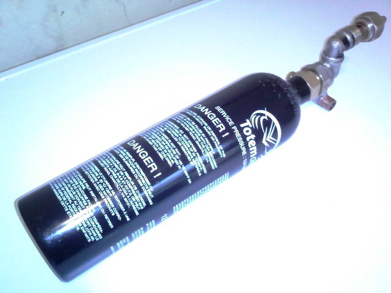

Is that a paintball tank? If so, what size is it (as in 20oz or 12oz or something)?
My cannons | My QEV cannon |
- wyz2285
- First Sergeant 2
- Posts: 2390
- Location: Porto, Portugal
- Has thanked: 1 time
- Been thanked: 4 times
12oz co2 paintball tank, service pressure 124bar.

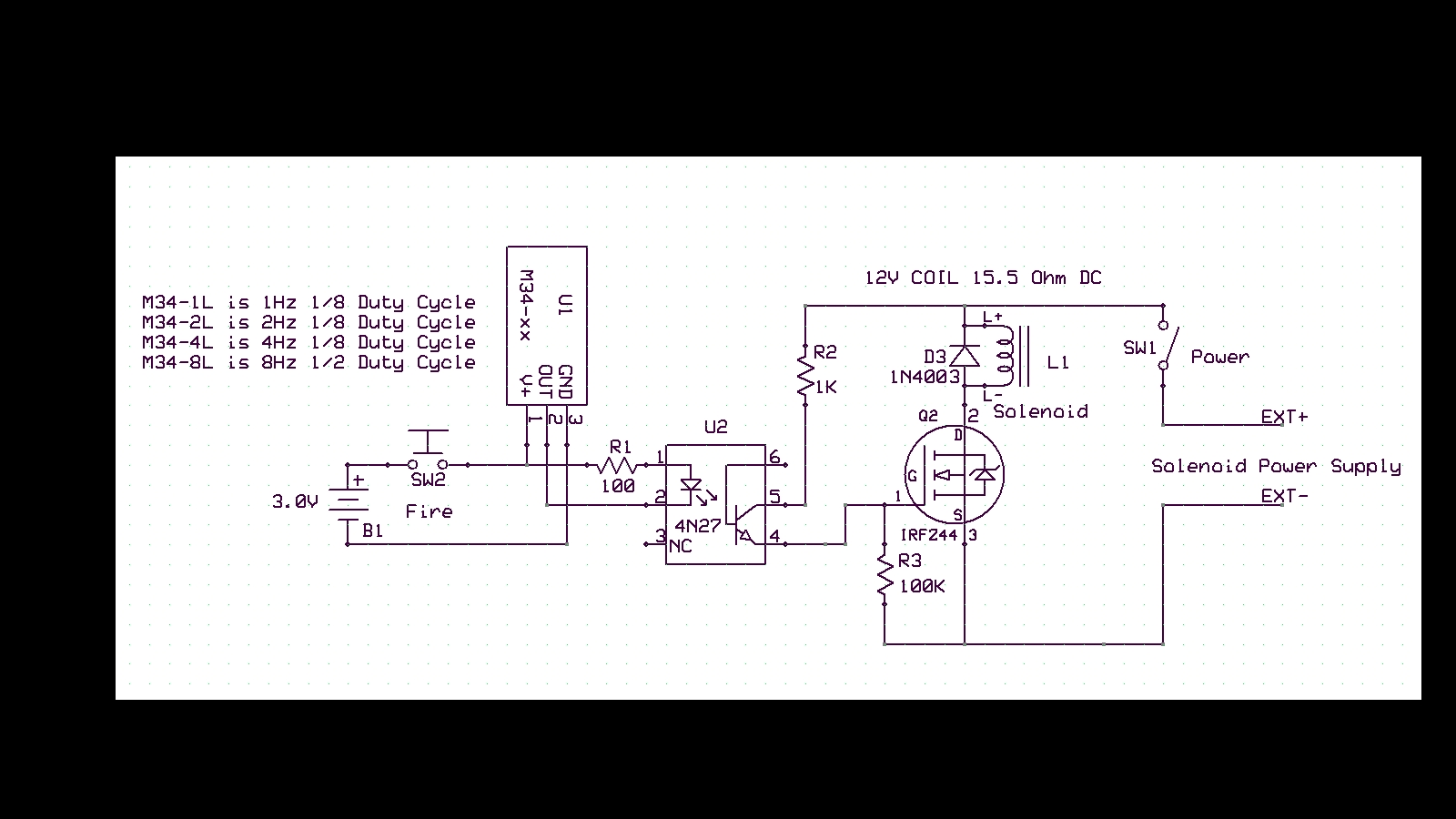

Here is the simplest method to use a M34-xx LED flasher on a solenoid.
There are several disadvantages compared to using dual 555 circuit that I have given to wyz.

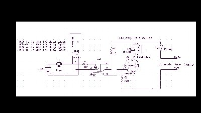

On your schematic, R2 is reducing the voltage to the opto-coupler and r3 is a pull-down resistor for the MOSFET gate ?
Haha, just got the circuit out again to have a look, plugged it in, and now the LED flash green; they used to shine red or at least orange (although some red is still visible), would that suggest they're now getting a higher voltage for some reason ?
That is correct.al-xg wrote: On your schematic, R2 is reducing the voltage to the opto-coupler and r3 is a pull-down resistor for the MOSFET gate ?
Here is a schematic for that link that has modified circuit.
