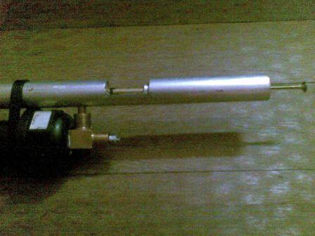

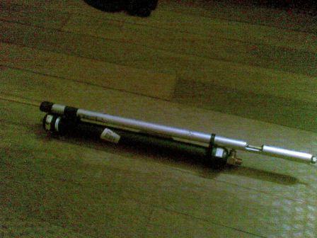

Just So you all know where im coming from i've made a ruff copy to show you all. The real plans are to make this thing run on co2 or hpa but for now this setup consist of a ABS air chamber (using shop air 120psi max ) a 1/4 tee hammer valve (Valve is a long bolt with filed nuts and o'ring as a sealing face, similar to Btb's & sniper hero's etc )which connects to a parallel 9/32 brass barrel located in the middle of a 12mm ally sleeve (sorry for the unit changes) and shoots 1/4 steel bearings. works fine now being assembled minus the hammer tube and trigger.
Sooo , what i want to do is using brass fittings, tread a hammer tube (Pice of brass or ally etc) straight on to the "T" piece BSP thread. Now the brain storm starts on making a sear/trigger setup which is relatively easy enough to copy.
"how should the sear sit, how should i attach the trigger mechanism to the hammer tube ?" I have a few idea's and will post a few diagrams a bit later , but for now any comments would be great 8)
Sorry for the pic's, i left my camera cord at work so these are from my phone . Im also new to posting so let me know where i've gone wrong.

close up
close up
setup
setup
