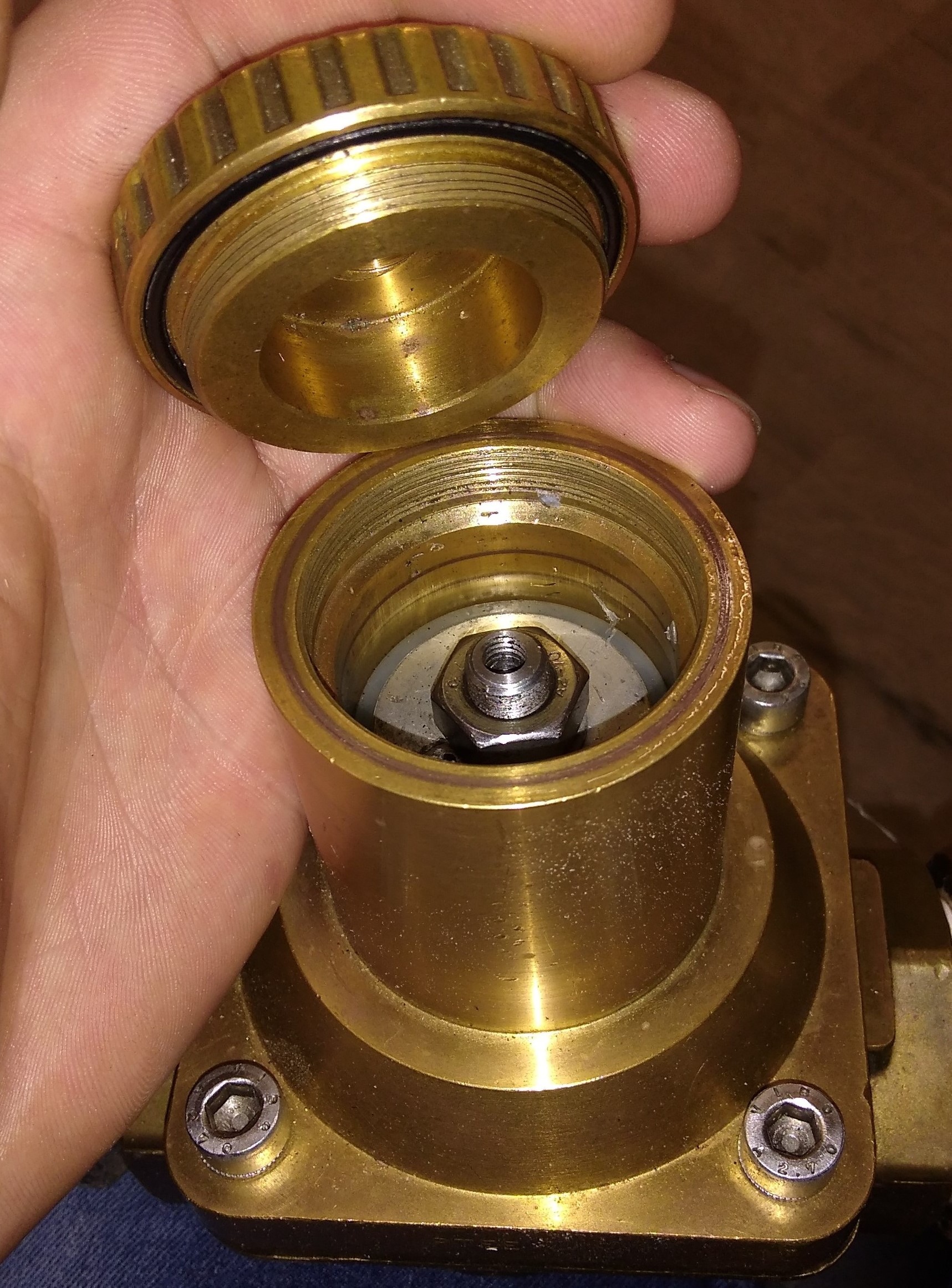

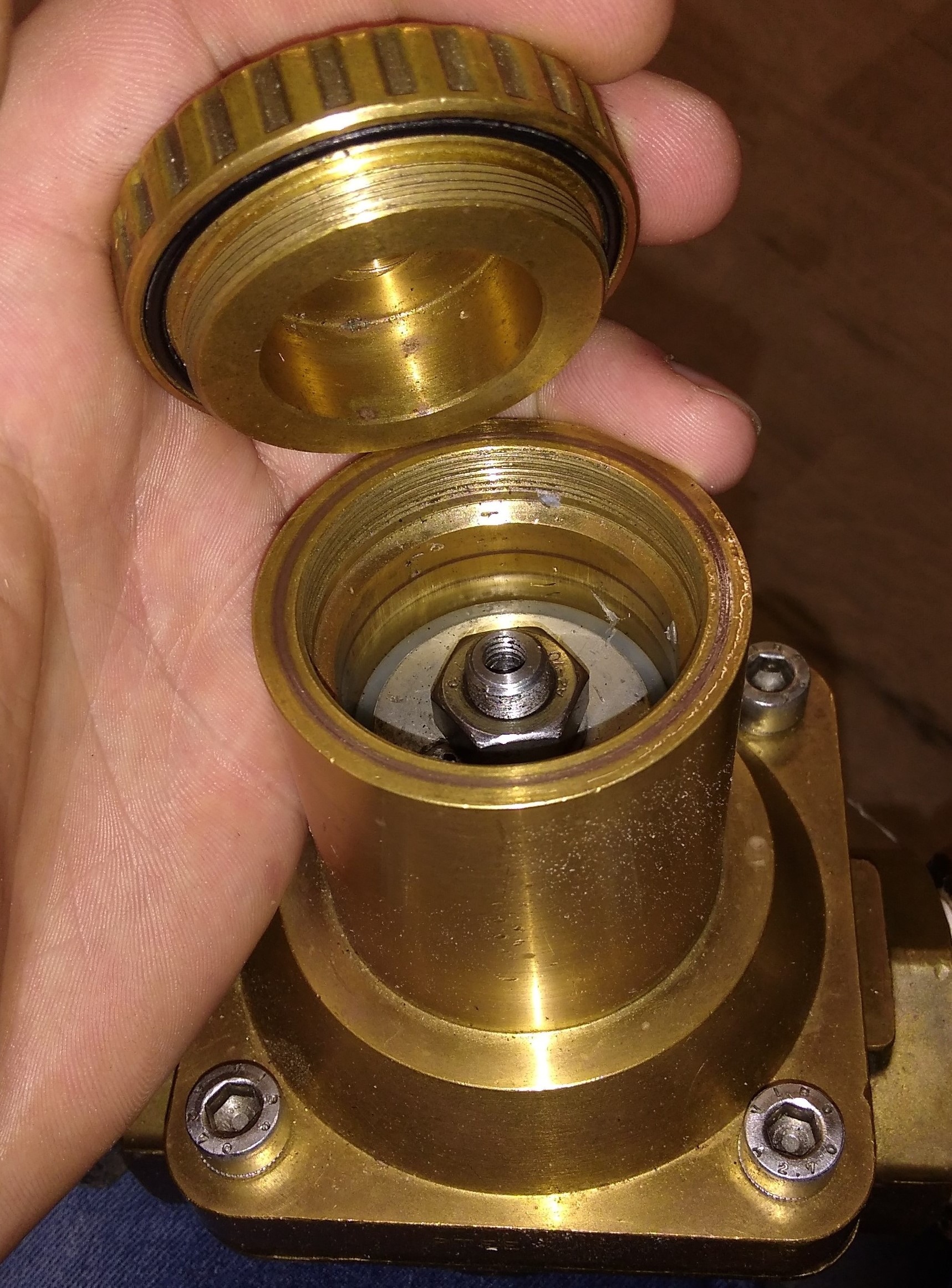

Well it's not a home built valve, i found it in a store that sold anything from used tools to straight up junk and just paid for the brass weight. The piston has a PTFE sealing face and I've never really noticed any leaks from the valve itself.
I think that for a valve of it's size the pilot volume is quite small. The piston is in full downward position in the picture.
That's a beauty... are there o-rings around the piston, or is it a cup/parachute type seal?
Alex345
Posts: 138
Joined: Sun Jun 13, 2010 3:26 pm
jackssmirkingrevenge wrote:That's a beauty... are there o-rings around the piston, or is it a cup/parachute type seal?
The piston is basically made from two discs, the bottom disc is the PTFE one that seals off the chamber and the top disc which is the one you can see in the pic is aluminum with a plastic ring around it that has a groove in it housing a large o-ring.
The two are connected with a stainless steel rod about a cm thick. The rod also passes through 2 o-rings so the pilot area is completely sealed off from where the action takes place when it opens. I slightly reduced the diameter of the rod where it passes those 2 rings as they serve no function air cannon wise, and they really added a large amount of drag when it opened so now it opens way faster and is still leak free :)
