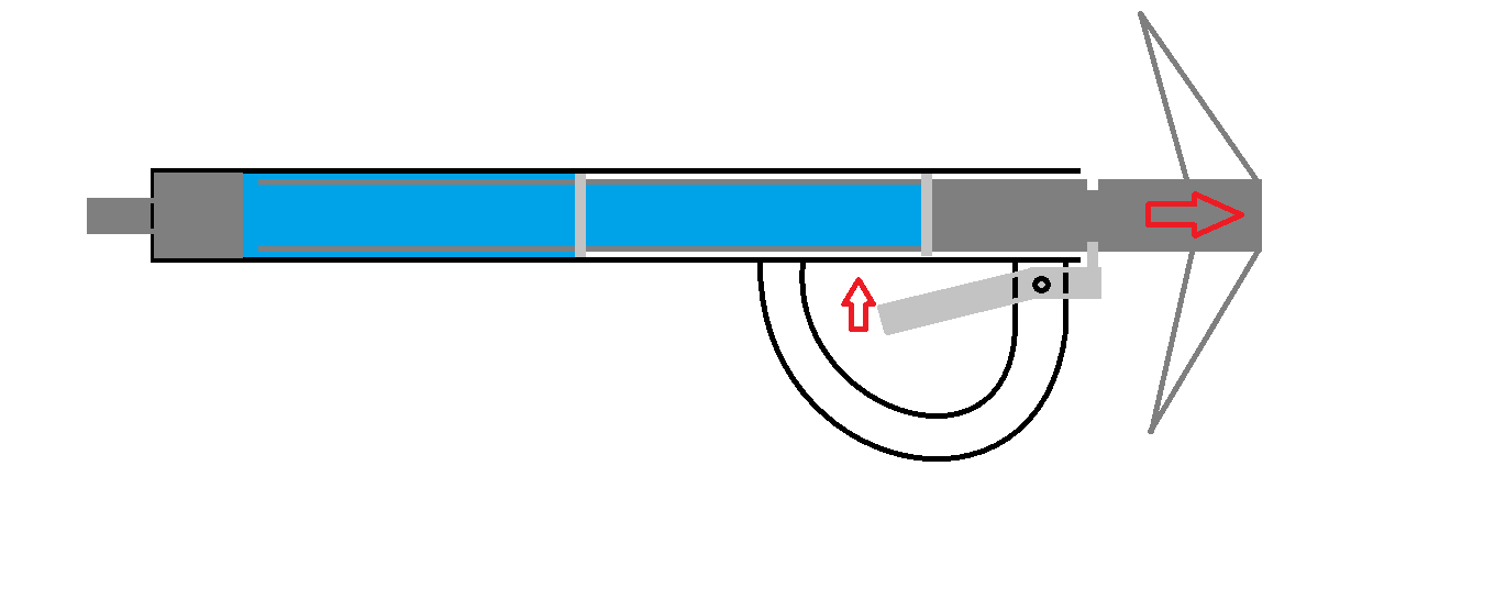

Something likethis?

No Jsr, It is not like the diagram you posted. My design is closer to that of Hotwired's copperhead pocket launcher in the way it operates (with respect to the hollow projectile, not the burst disk)

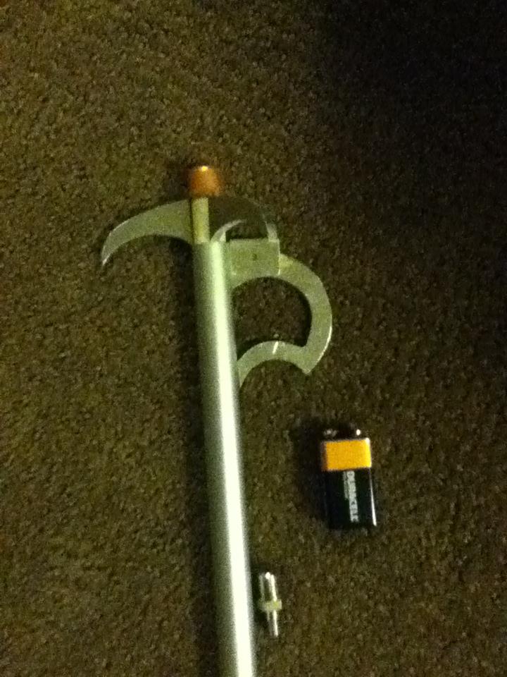

I'm just going to do a drawing to get us all on the same page but in the mean time, heres a pic of the outside (all Al)
edit: the hook/projectile is just a mock up and the big roundish thing is the trigger guard

More like this then ;)
http://www.spudfiles.com/forums/mini-ca ... 20262.html
Looks good, just remember your trigger needs to be very strong - at just 100 psi for a 0.75" dia tube, there's around 45 lbs of force trying to rip it off.
kydavies
Posts: 258
Joined: Thu Apr 22, 2010 9:09 pm
Location: Comox BC
Im using 1/2 Al for the chamber and The trigger and latch mech are going to be made of mild steel sobi should br alright. Even so im going to beef up the trigger.
