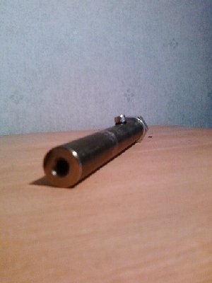

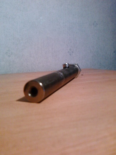

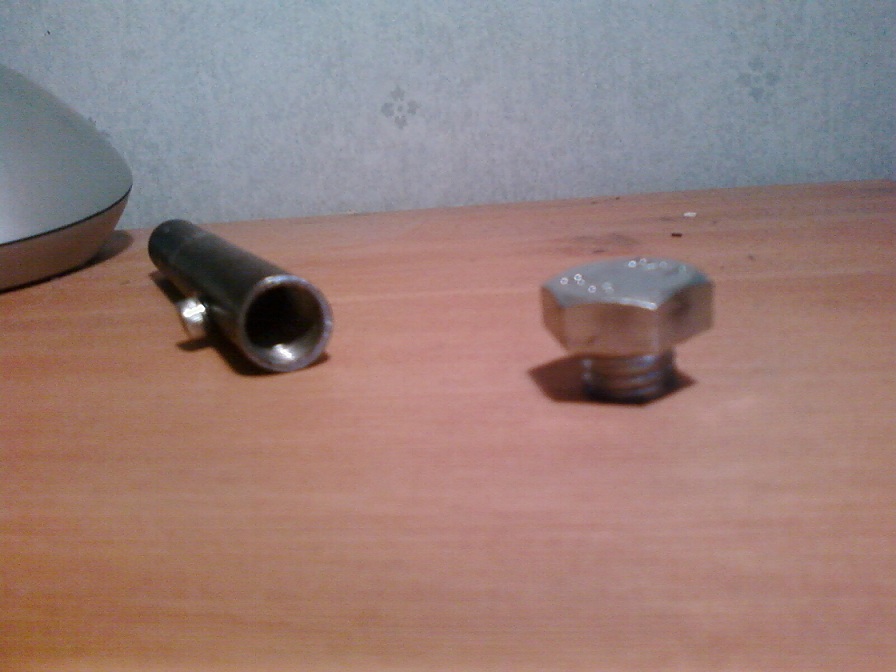

When JSR got the mini-hybrid working on high-mixes, i decided that i want to build something like that. Well today i had time and went to my workshop. Then i saw an old .177 cal airgun barrel. I got an idea, and here it is. Basically i drilled 11mm dia hole about 34mm deep and i left few inches long barrel. the combuction chamber is 11mm x 24mm, so its not big :D . The small screw on the top is for the iongition and has 1mm hole thhrough it, and after i took the pictures i epoxied a wire to it, it has about .1-.2mm spark gap and i can adjust it if i need. I tapped screws to the bottom of the combustion chamber to alloy me to plug it with a bolt. Today or as soon as i can ill epoxy a presta valve to the bolt so i can feed this baby :D . heres a picture of it
EDIT: heres one more pic

looking good, how much barrel was left as barrel? :D. What's your ignition source. and how are you putting in burst discs or is it jsrs patent dent system :lol:

ah sry i forgot to say, but iv seen that the ammo is so tight that it doesnt need a bursk disk. whit low and medium mix i mean. i have putten 130psi and the pellet didint even move so it doesnt need a disk. For ignition im using BBQ igniter from olf grill. And the barrel is about 5cm locg. this one is not for powerm this is for the compactness :D
