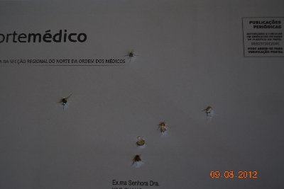

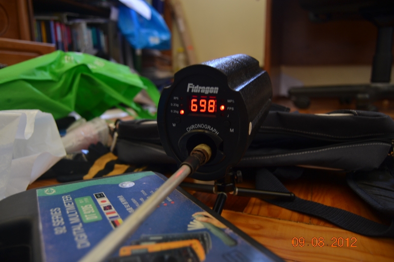

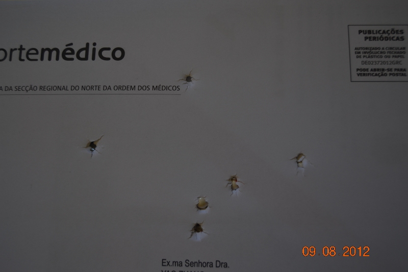

I have steel bbs and if this gun really work out well, I may use a pellet gun barrel. But for now 0.40g bbs are accurate enough for up to 50m.
- wyz2285
- First Sergeant 2
- Posts: 2390
- Location: Porto, Portugal
- Has thanked: 1 time
- Been thanked: 4 times
Test made at 8 bar, 0.25g bb.

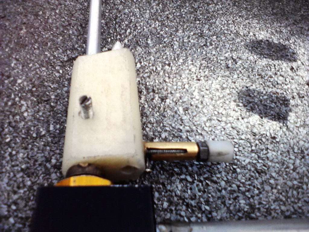

Has anyone ever employed the use of an airsoft hop-up? It seems like all of the bb/airsoft guns that everyone makes disregards this part.. It would seriously increase the range and accuracy on your gun, and make loading a hell of a lot easier..

Finished the reload/magazing block, also added a homemade hop up, worked like wonder
with only 5 bar I was able to have a effective range of 40m reliably.
